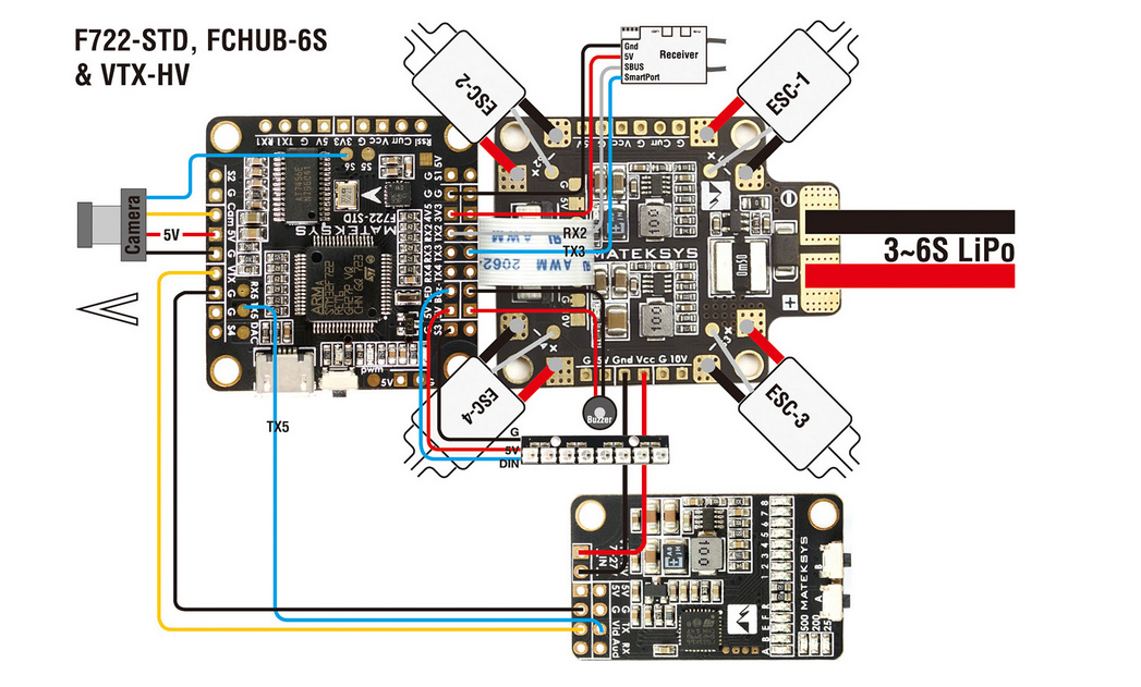

You need to power the matek F7 with a 5V power source. Most of Matek flight controllers are desgiend to be used with one of their power distribution boards.
If you want to use the Matek F7 with your 14V battery, you will need ot connect it to the FCHUB-6S:

Below is a image of ESC wiring with the Matek F7

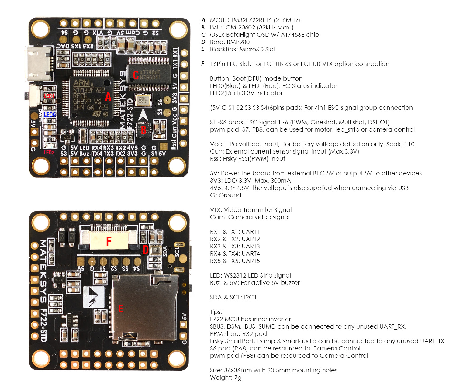

For connecting GPS, you need to connect the compass to the SDA and SCL pins on the bottom of the Marek f722. For the gps you just need to hook it up to one of the unused UART ports. Diagram below helps you identify the correct pins on the flight controller
The two things that catch most people out is that depending on how your GPS module is labelled, you usually need to connect tx from GPS to Rx on FC, but if that doesn’t work, try connecting tx to tx.
Lastly you may need to adjust the baud rate on your GPS module if swapping the cables doesn’t work. Busy most ublox modules have the correct baud rate set out of the box.
