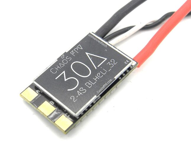

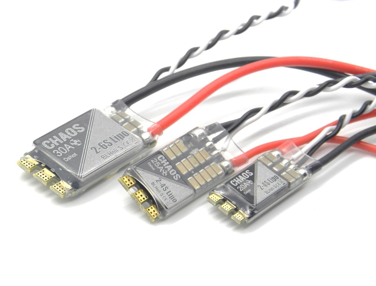

Hi Dale589, sorry to trouble you again, i know i’m a pain in the…you know where…lol but can you recommend a set of those BLheli ESC’s please, i think 30A should be ok?.. i filled in the info in eCalc and that was fine with 20A but how true it is i don’t know???.. anyway i’ve done a rough weight estimation of all the parts needed, frame is 420g, one motor 4006 380kv 68g, prop’s CF/FC/PCB about 150g, battery 640g, about 1500g total, ok then Dale, thanks alot for your help and time, byeeee
I use the top ones as 32 bit where not around when i got those.
only ever had 1 fry but was flying in very damp conditions.
Cheers Dale589…i’ll order five just in case one does go down then…lol thanks for your help again Dale… :+1:
