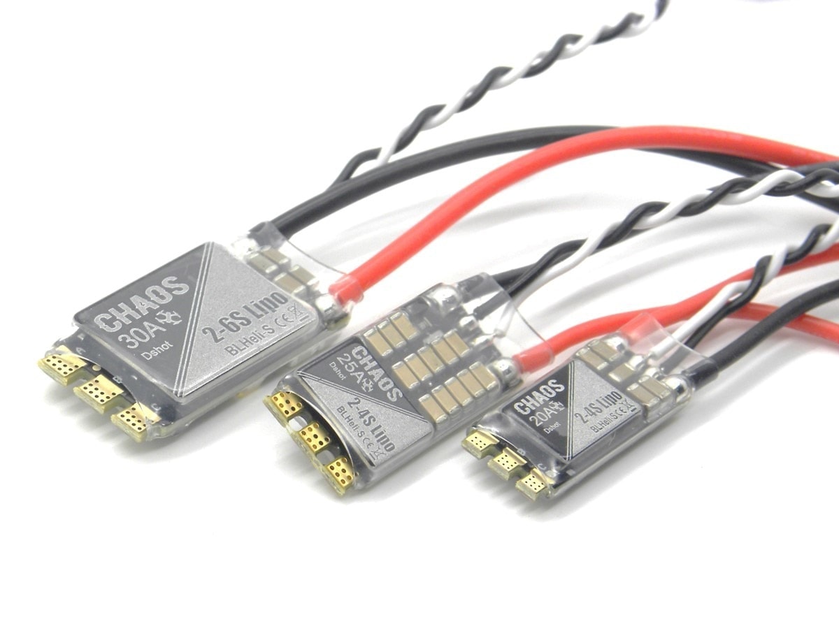

Also Blheli-S or Blheli-32 ESC will be better.

Use different ESCs
Simon K ESCs are really old and don’t work very well with Quads your get a much better experience with some 30a BLHeli ones.
they work well and are cheap.
