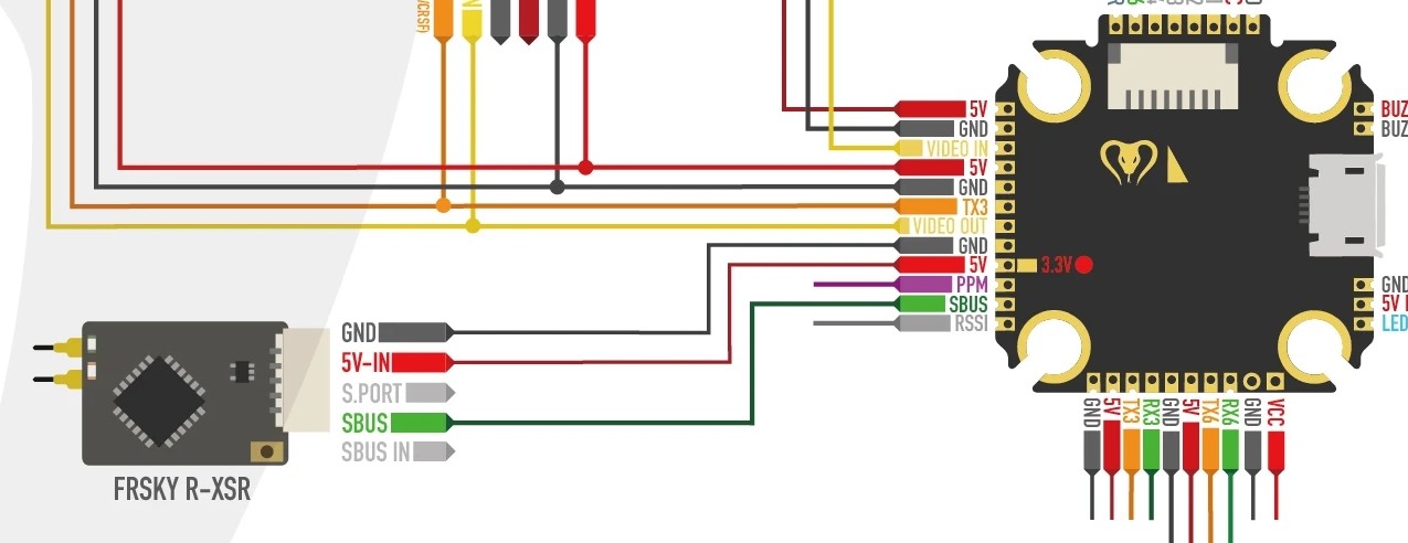

Hello Folks just joined Dronetrest and trying my first build . I have a Mamba 405 MK 2 30A stack that is having issues with the XM+ not communicating with the reciever . The reciever is bound but nothing happens in the reciever tab in Betaflight . Yes the battery is plugged in . Any advice would be appreciated , Thanks !

So receiver is bound so I presume you connected the wires correctly to the FC, black to ground, red to 5V and the (usually) green wire to the SBUS pad of the FC.
Make sure that wen you turn on the transmitter and power up the receiver you see the green led, indicating the receiver receives commands from your transmitter.

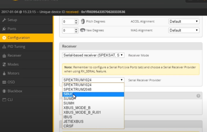

Next step, BF.
No need to plug in your battery, unless your receiver isn’t powered by the USB connection.
Configuration tab - Receiver. Serial based Receiver and SBUS.
It should look like this.
Save & Reboot if u made any changes there.

Activate “Serial RX” for the UART 1. Default for most Mamba 405 boards is UART1 for SBUS.
Again Save & Reboot.
Check if the correct settings are still in place on both tabs and if so, try the receiver tab and all should be ok.

Hi and thanks for geting back to me . Yes I wired it according to diagram , and it is the mamba 405 mk2 30A . I did try all that and the reciever is a solid green . Zero response on the recievers tab or the FC . Been choked for about 3 weeks now
