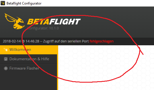

The betaflight is a GUI and the receiver is bound to the Radio. the problem is that the drone connect’s to betaflight sometimes and if ti connect’s as soon as you unplug it to test and you plug it back in it does not want to connect.
What does Betaflight say, when it wont connect?
Dont get confused… Mine is in German
Luca
It said searle port sucsesfuly open and then after 10 sec it said failed to connect and then it said oprt sucssesfuly closed .
That might be a driver issue, try using the driver fixer here to see if that will work - Fix any STM32 DFU Drivers issues when flashing Betaflight/Cleanflight firmware as then you should be able to connect to betaflight.
