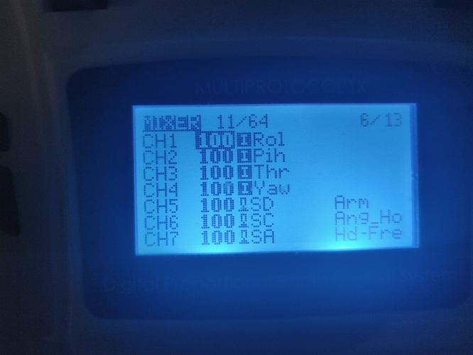

Did you set up mixer in the Jumper? I was having problems and couldnt arm until I set up mixer (I have T12 too)
Thanks BUGS2C I’ll take a look, I didn’t think of look there as I have OpenTX on the T12plus, but information is information and it might point me in the right direction.
Thanks blackhole,
I’ll check the mixers, I definitely haven’t got the switches set the way you have them as I hadn’t found the channel mapping yet, so that’s a great help.  Haven’t got my Hubsan with me at the moment so can’t check anything until after Christmas now
