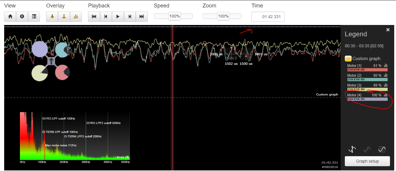

Hi, this isn’t a serious problem but it is a little frustrating I have been trying to eliminate the jello from my HD footage. so far I have soft mounted the FC( Kakute F4 AIO V2) but apparently, it has the soft-mounting built in. The IMU (“gyro”) chip on this board is mounted on vibration-isolating foam. I’ve also soft mounted the motors but I can’t get rid of the jello. I’ll share some blackbox data here if that could help identify the problem. other than the jello it flys really nicely. i tried to do a few bits and bobs so there should be plenty of data. if you need footage of the flight related to the blackbox data i shall upload it to youtube and share the link. Thank you so much (:

Hey, I’m curious, have you tried anything to fix your perceived problem? Did you try 6" props? Did you make any adjustments to motor 4? Were you planning on flying long range with the 6" Chameleon? I was thinking that trying a lower KV motor with 6" props might smooth things out for you to your satisfaction. Just some thoughts. Please let us know how you have progressed, or what, if any, changes you have made and what the results are. Thank you Guan.
