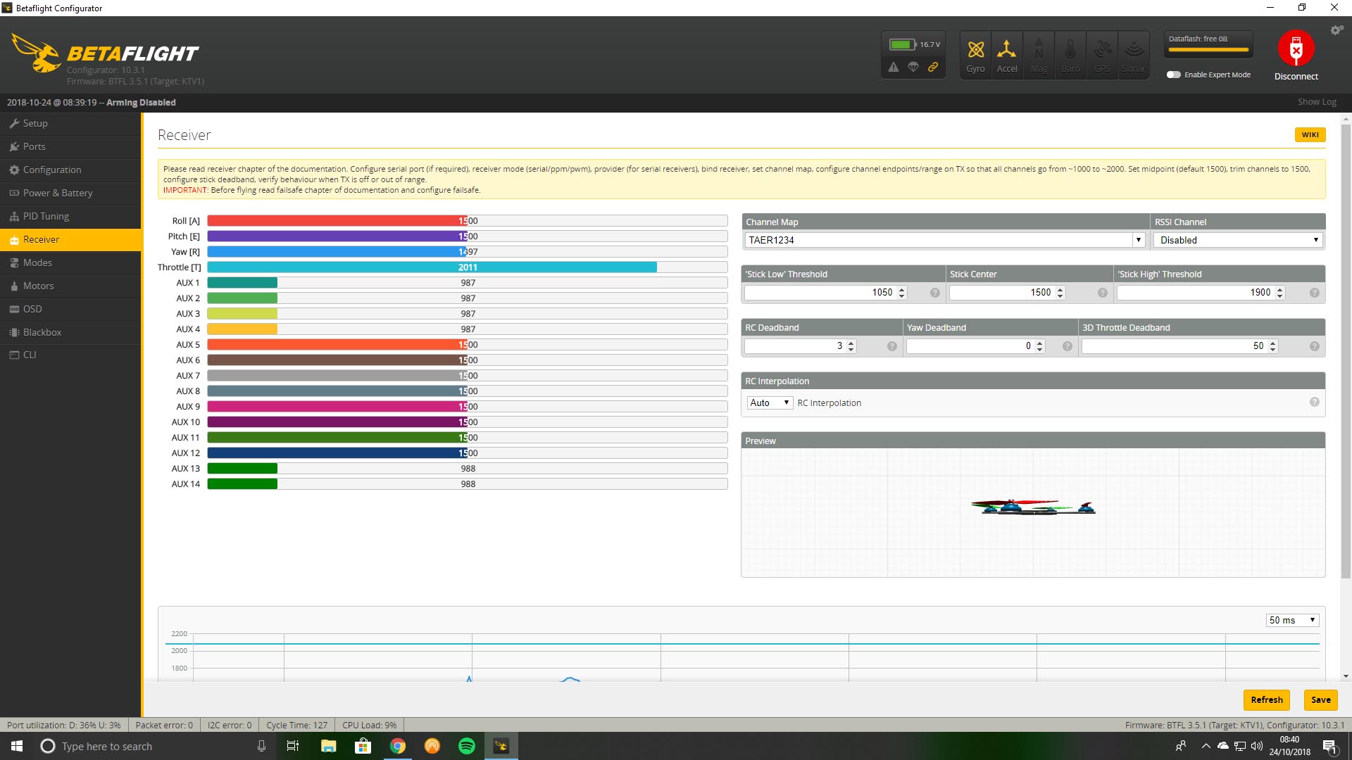

Hi thanks for getting back to me. The sticks go up 2011 on throttle and the total weight without props is 644 grams. I’ve never re flashed the firmware with full chip erase before. i’m sure ill be able to find a video for that. i have included the current betaflight receiver tab in case there is anything obvious i am missing
Change
‘Stick Low’ Threshold = 1010
‘Stick High’ Threshold = 1990
That will give you more resolution over the throttle.

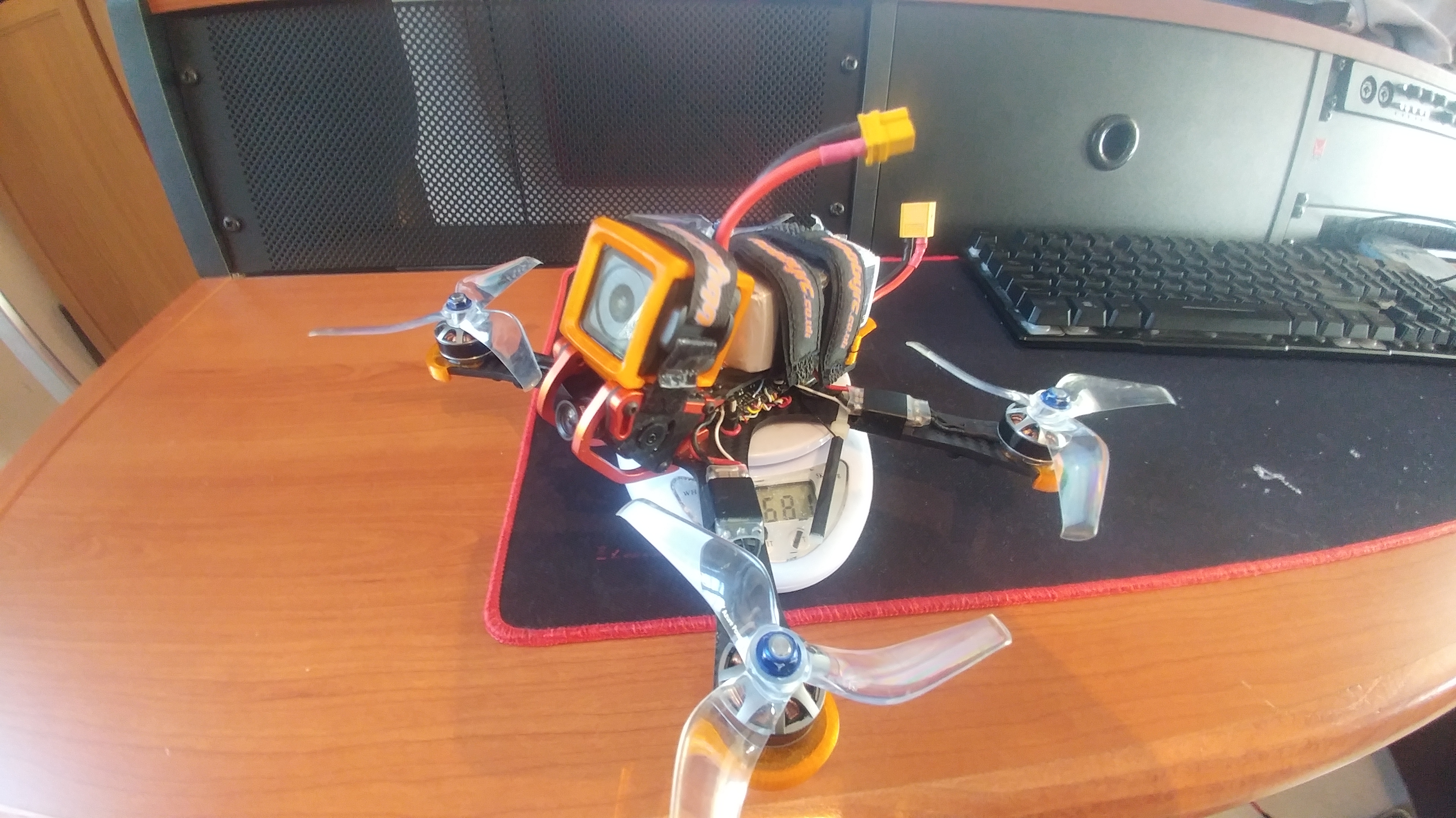

Any pictures of your build?
It’s 681g with everything on. I just took a moment at the local park to test it. and those changes seem to have made a difference. i didn’t get to test it for long as i crashed it and a motor was smoking when i tried to fly it again. Will i need to replace the motor and the esc or just the motor?

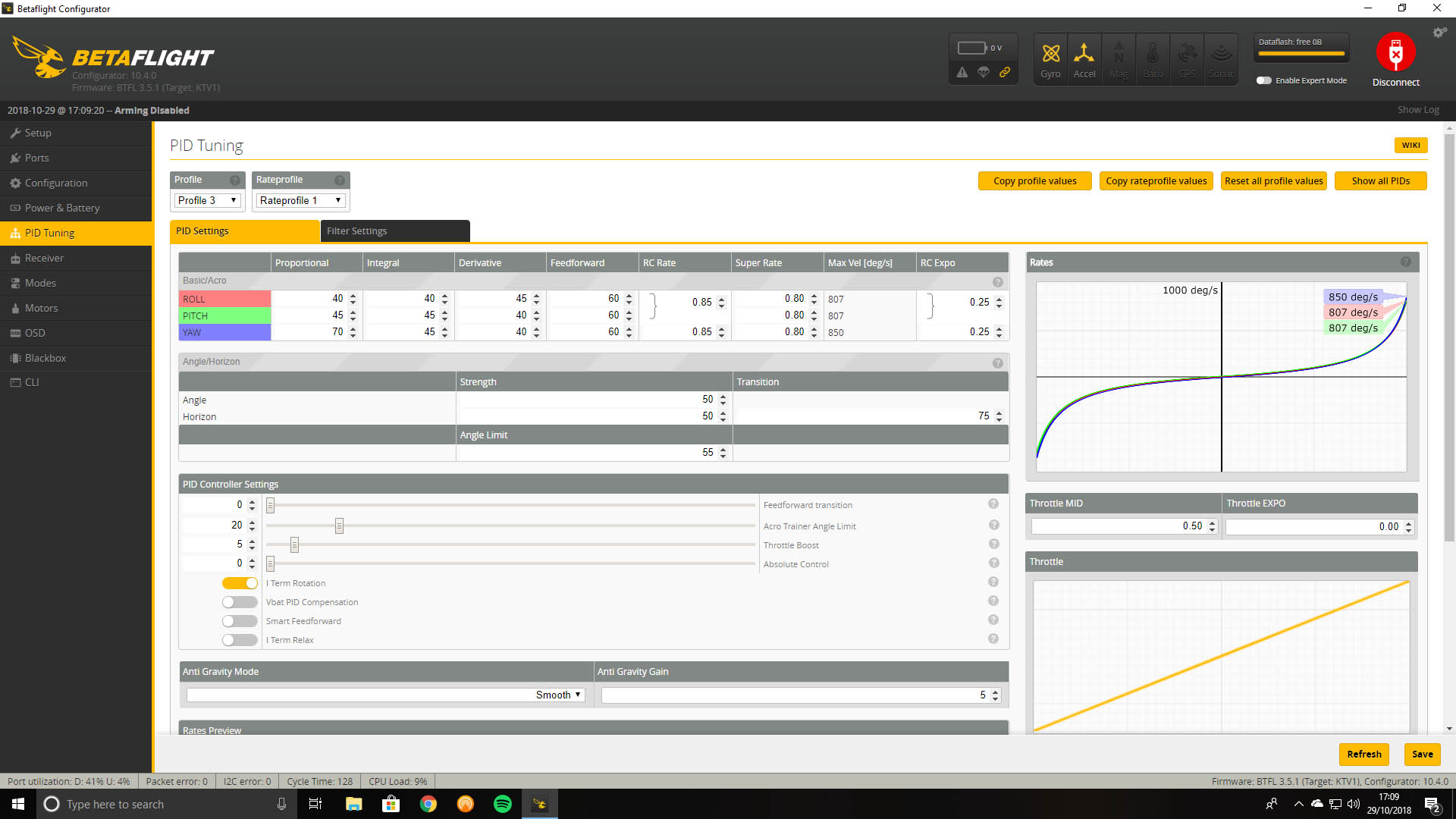

I hope my pids settings arent to stupid i was trying to tune out some of the jello and i had seen in a video that can be done by increasing the D gain.
Here are my Pids
After the crash i noticed the motor that smoked was hot but the others was cool. they are always surprisingly cool after flying. I did change the d gain in yaw before i went out to fly yesterday as the option wasn’t there before i updated betaflight. Should i put that back to zero?
I have a motor coming today so i was hoping to minimize the chance of it being down to bad tuning.
Thanks again
D gain on Yaw is a lie… its not there… just put it back to zero
** Yaw D is experimental. For normal quads, do not add any D to yaw, or you’ll likely get mad yaw oscillation.** Yaw D may be useful for tricopters.
Your D’s do look a little high to me for your P gain’s
P and D is a balancing game. but if you motors are cool after you land then your D gain may not be a problem.

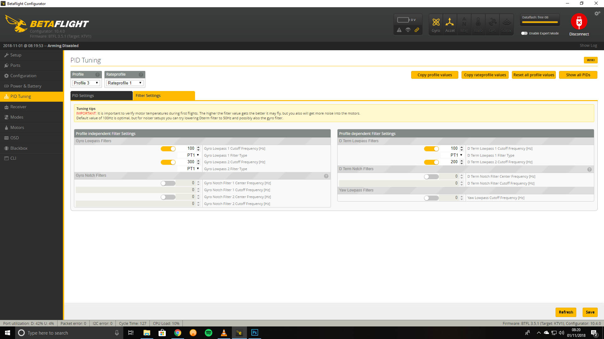

Good morning. I swapped the esc and did a 30 sec hover test and the motor isn’t to hot to touch but it is warmer than the rest could i have done something wrong or the problem be with something else. i have also lowered my D gains. i am attaching a screen shot of my pids and the filters tab in case there is anything wrong there although i have never changed anything in the filters tab
Thanks again
So the motor is warm after lowing your D gains… ( we could be onto something )
Try dropping your D gains down to 25 on both pitch and roll.
This will probably effect your tune but at the moment I think its more important to stop your motor smoking.
