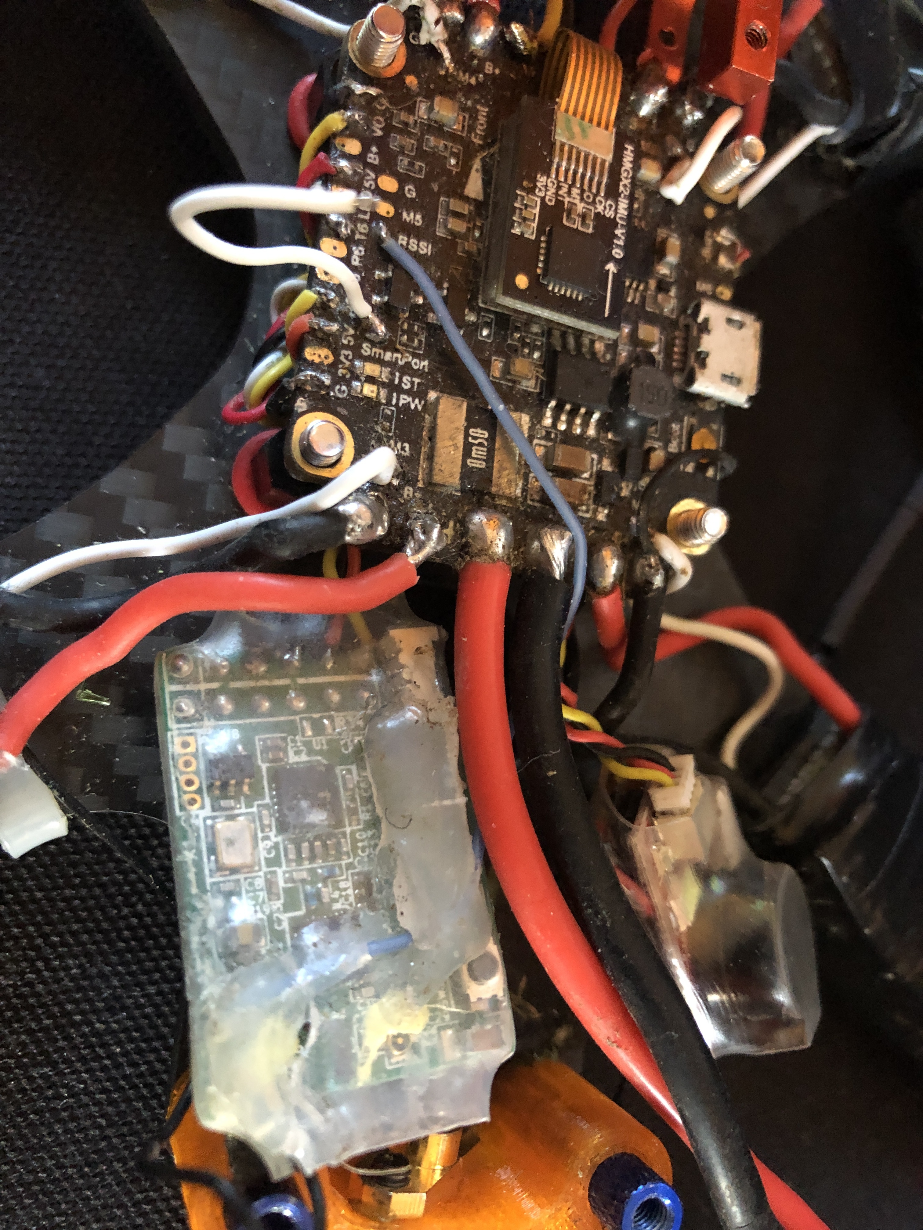

I may have found the culprit or its just a coincidence but the wird from the smart port has come lose. im not sure where to re solder it too. Still a bit lost with this side of things (:
It looks like it curled round somewhere but I can’t see where it was connected to. I can’t see where it may have come lose from the receiver but I’m assuming that is where it goes. Just not sure where about on the receiver
I think i have worked out that the cable from smart port goes to the receiver. i could be wrong but once i had soldered it onto the receiver i had telemetry and my radio worked again. unfortunately you are right about it being toast as it wont give me all the beeps unless its plugged in via the usb and a lipo. Time to buy a new FC (:

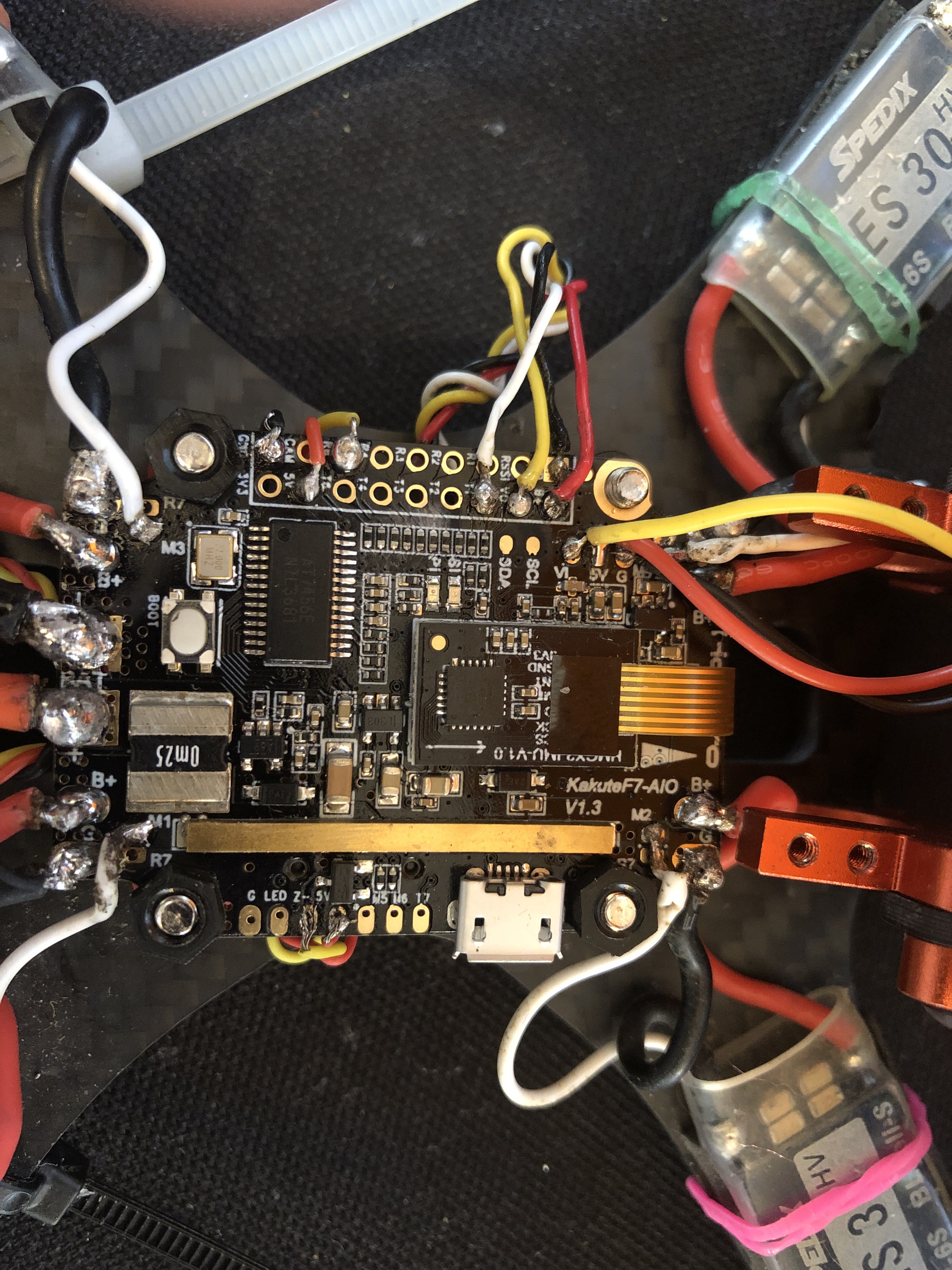

Not good i plugged it in and i got a little smoke so unplugged straight away. I thought i had got it right… shit ):
Honestly I tried my best but being a nervous person i get the hand shakes. Is there anything obvious that would cause a problem?
When I checked continuity the I was getting small beeeps where I though i shouldn’t but because I was getting a continuous beep on matching cables I thought it was ok
