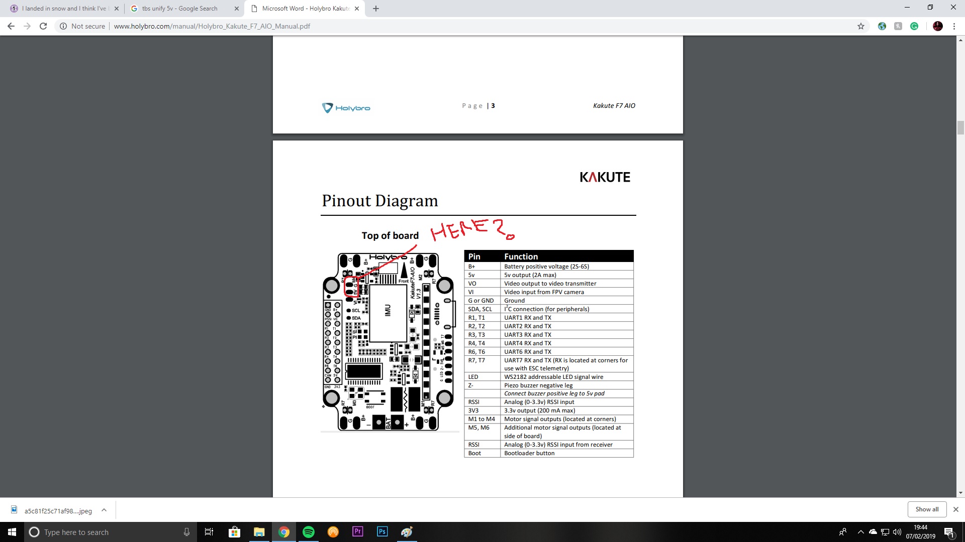

understood. Did you mean hereYes thats what I mean. Both cam and vtx to those pads. But I will check for you when I get home just to be sure as I am working from memory
Thank you for your help Max. (:
Damn I took the wrong drone apart, my Hyperlow does not use the same pads due to a different HV VTX. But on my Rooster I am running Cam and VTX from those flat terminals you pointed out and its fine with no interference. I have just prepared the Rooster for a Dronetrest meet this weekend and I’m a bit loathe to take it all apart for a photo but trust me that works with no problems.

Hi thanks Alex. Managed to get back into the air. Max had pointed out that maybe it was vtx I killed and got the smoke from and not the new fc because I had wired the tbs 5v to a vbat pad. So I changed the way at was wired and nothing changed so I used a SRC Bucaneer Switchable VTX that I had spare and all is working. Looking forward to testing it properly tomorrow. Only thanks to all the help I get here or I’d be completely stuck (::
