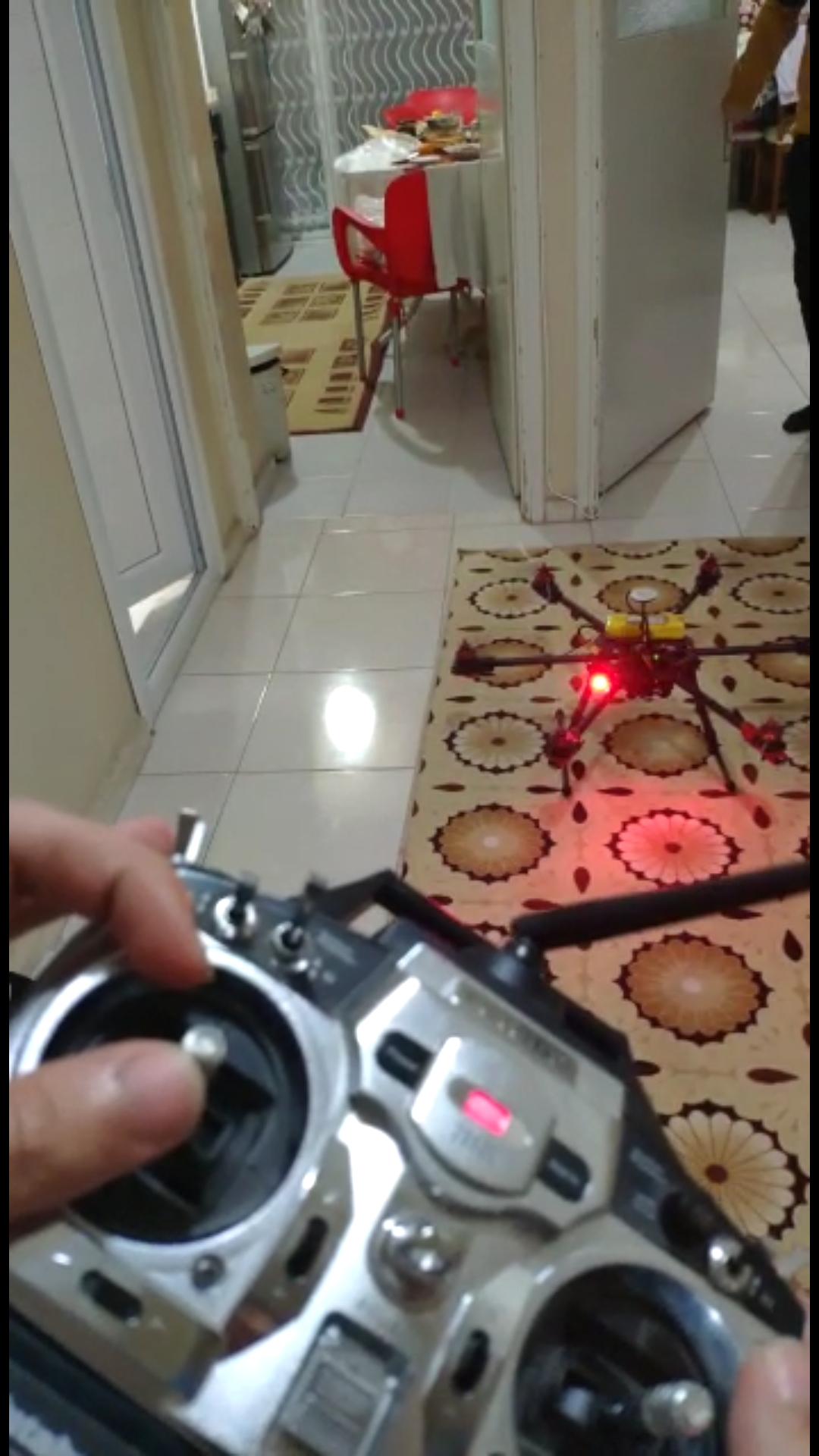

I am having trouble with the departure
I am having trouble with the departure.
Iโ€™m gassing. but the drone is not getting up. Engine and propeller aspects are ok.
Battery power 14.8v help
How many kV for your motors? What propellers are you using?
380kv motor
13x4.0" pervane
Please provide some more information about Motors, Escs, All up weight etc.
It is kinda hard to troubleshoot with only the information that ypur Drone is not lifting up.
Please see: ๐Ÿ™‹โ€โ™‚๏ธ How To Ask For Help - A step by step guide on how to have your questions answered
Ok, and what is the All-up weight of your drone? Looks like it may be slightly underpowered considering youโ€™re running 13 inch props on 380kV motors and 4S. A setup like that would probably run best on 6s.
