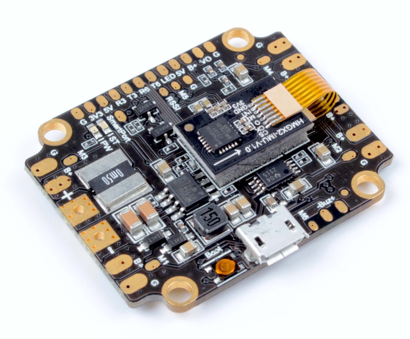

- It has a vibration isolated IMU the ICM20689 connected via SPI which lets you run at a full 32Khz update rate without worrying about vibrations (on paper for now at least)

- Soft-mounting built in. The IMU (“gyro”) chip on this board is mounted on vibration-isolating foam. This means that there is no need to soft-mount the board itself.
- New high-performance / low-noise / high sensitivity IMU. ICM20689 with 6-axis gyro and accelerometer. Can run at up to 32 kHz.
