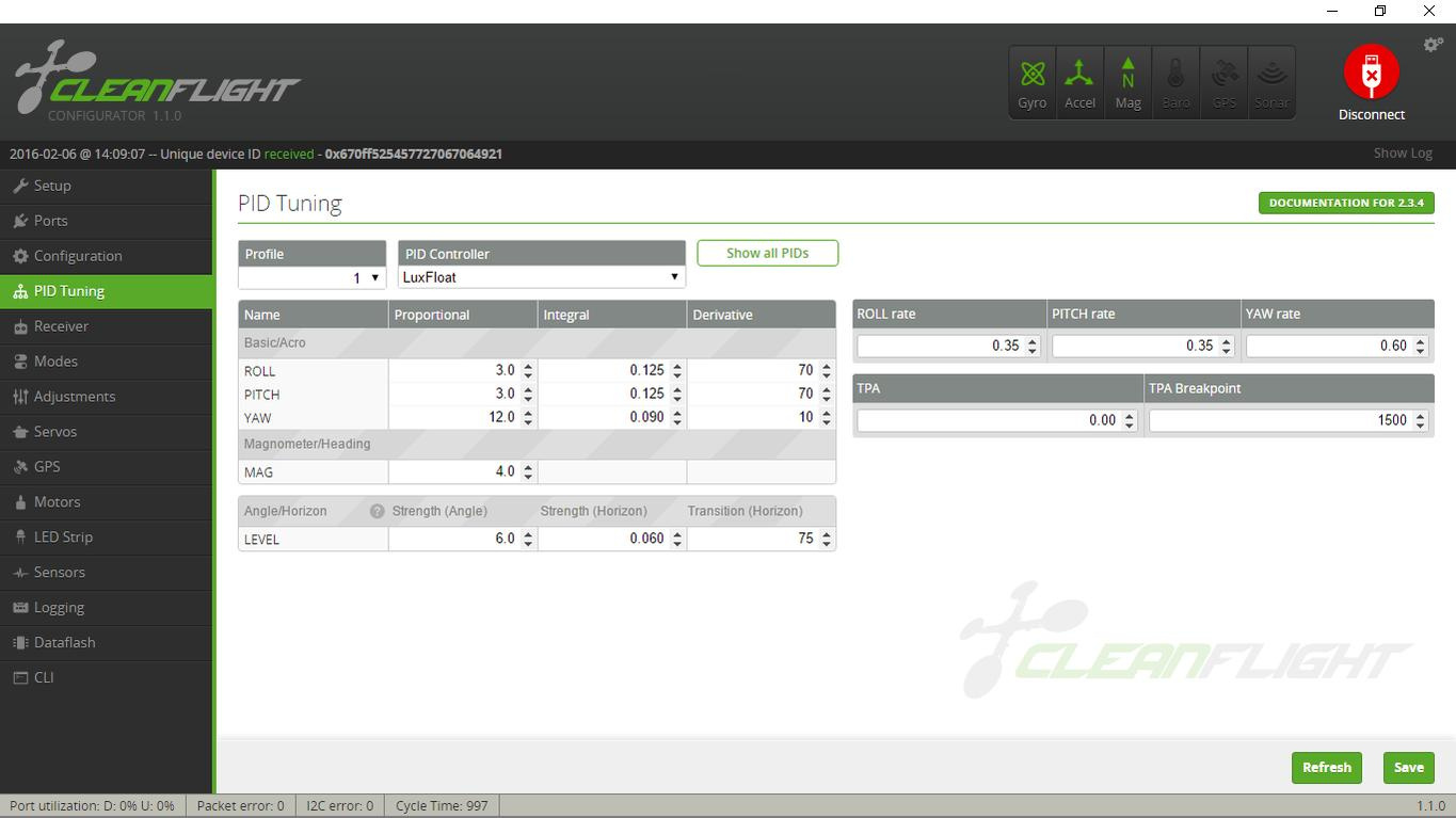

Hey, looks like you have some bad PID settings on your quad, see screenshow below for some suggested PID values. Also note that the PID controller is changed from multiwii to LuxFloat as its generally better:
Thank you i will apply these as soon as im home i will let you know how it goes thanks (did you watch the video)

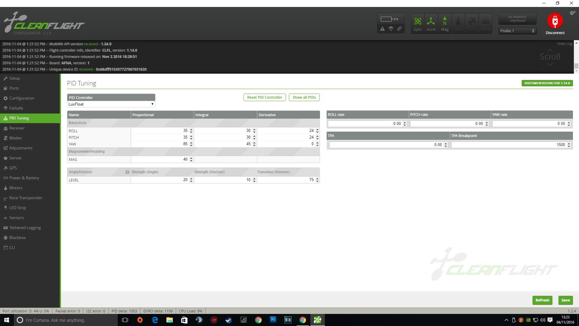

TRY THESE im just learning how to do it i got her to wobble less
it doesnt help the fact that you are using an older version og the config a they no longer use (0.0) its just (00) now :confused:
looks like you need to soft mount the FC with some o rings over and under it :slight_smile: should help a little bit…
allso try raise p gain and i gain… d gain is the last thing you raise…
its a nighthawk pro eveythink is on one board :confused:
raise the p AND i gain seemed more stable when i put it to the settings above in pic
try raise i gain to like 50 in all axis. and raise p a bit more to like 4.5 on pitch and roll. ifit shakes really fast then lower it like 0.4 points…
