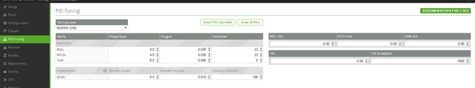

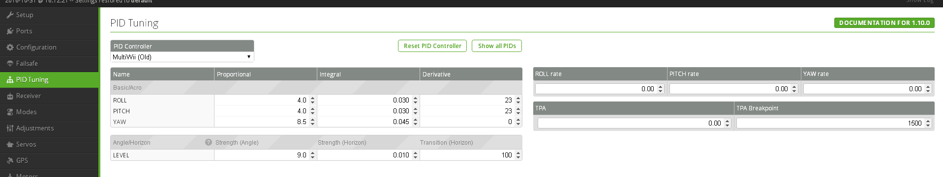

Here are the default PID values for the nighthawk from emax that they just send me. So I suggest you try those, they use the old pid controller but should atleast be a starting point.
