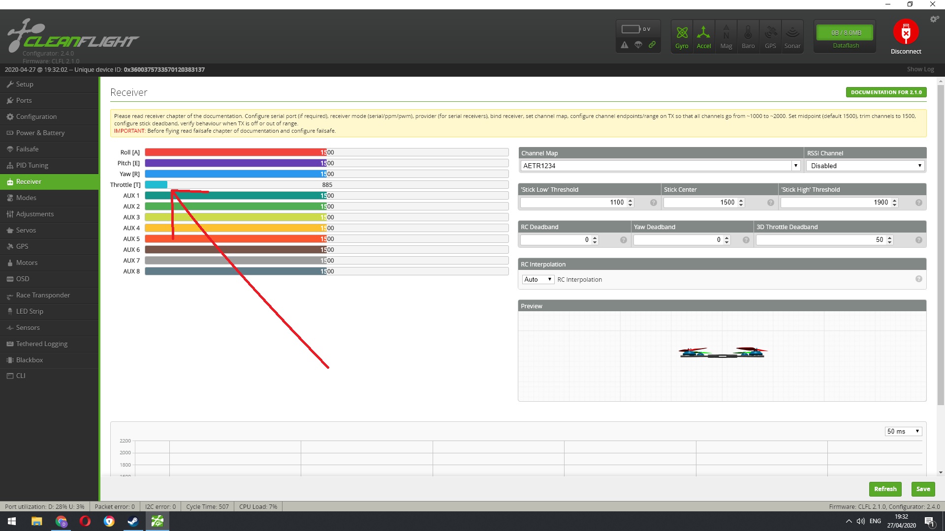

2 make sure in reciever tab that throttle is throttle, roll is roll ETC. and at idle the throttle is below 1000us.

so i recalibrated the accelerometer , the pic moves same as the quad, i rechecked pitch roll etc, in the installation screen on the right ‘info’ it say msp (wich i understand its normal when u connected with cable, and it say throttle when i put up the throttle stick
is you throttle below 1000 here at idle

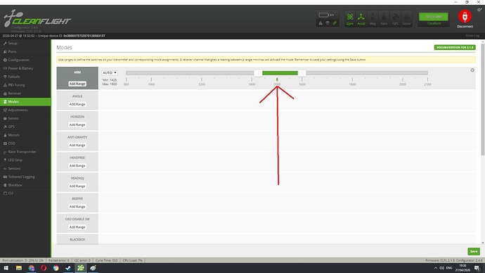

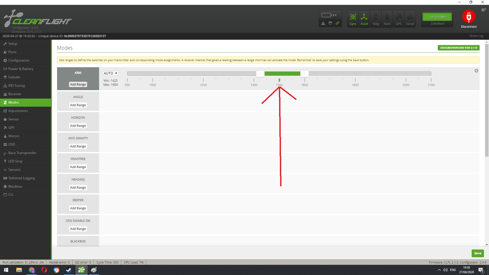

and you are aware it wont arm with USB plugged in. and make sure when the arm switch is armed the slider is within the arm area
that value is 1000 but low stick treshold is 1050 so that should be correct? how can i lower that value?
the mode i just corrected, was fm 1000 to 1200 i put same as yrs
1000 should be ok but i like it to be 995 ish. you can adjust end points on transmitter, TBH it dont matter on throttle if you just move the throttle trim on your transmitter. should be a button to the right or left of the throttle
the mode doesent need to be the same as my example, it needs to be where the little marker is when you switch the arm switch to ARM

when i adjusted the arm mode , that what triggered it
in the reciver TAB dou you still have 2 aux channels working?
when u said ’ it needs to be where the little marker is when you switch the arm switch to ARM’ i did it and started working
