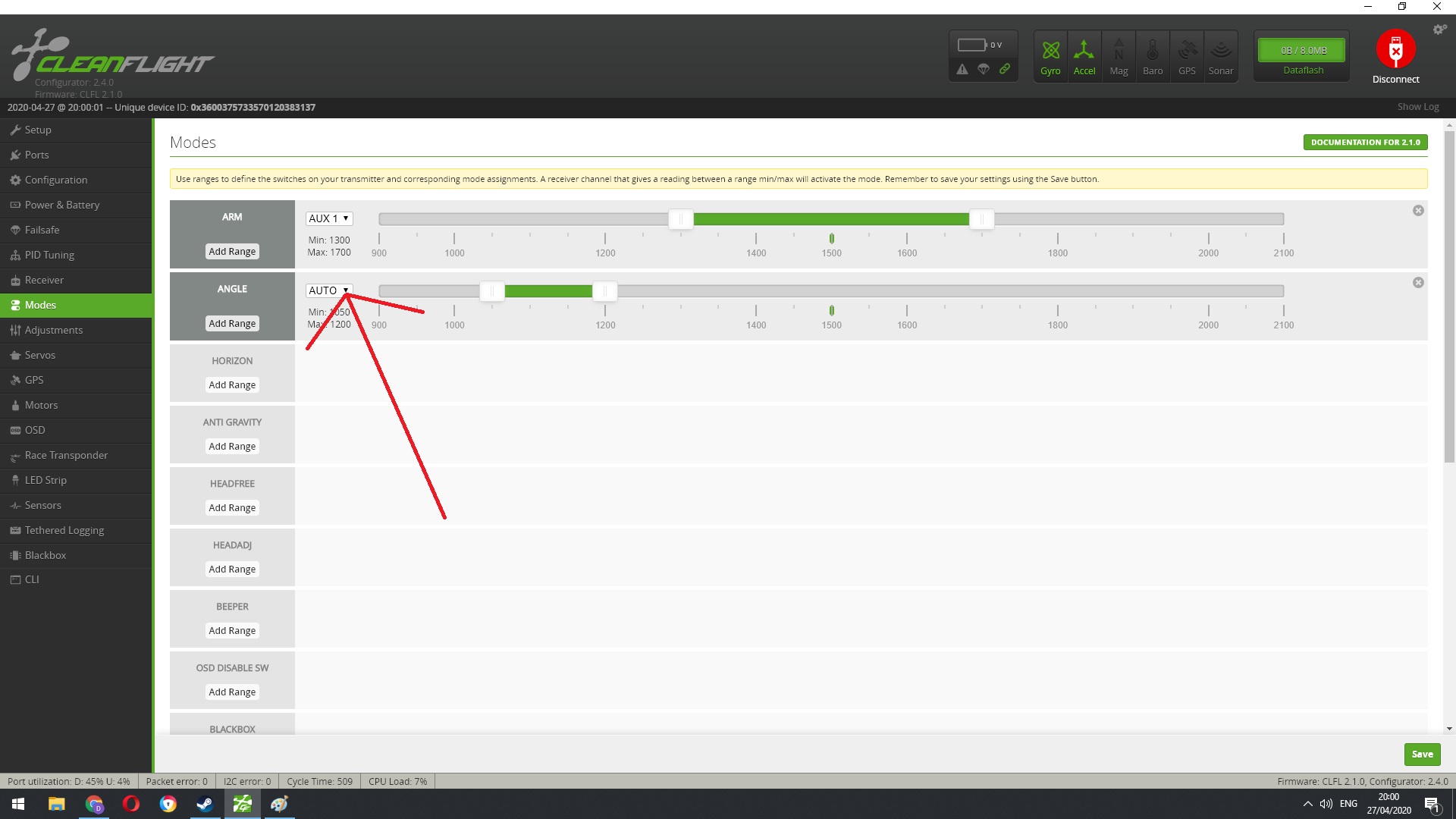

in the reciver TAB dou you still have 2 aux channels working???
tha left switch is aux 2 ! so i should put aux 1 right switch for the 3 levels?
yes when i trigger it it moves
r u using a 2 position switch for ARM and a 3 position for MODES
then move the green bar to where the marker is when the switch is in the angle position.
that was the confusing part as it wasnt arming as you said here, the red light was coming on because the throttle was not at idle
