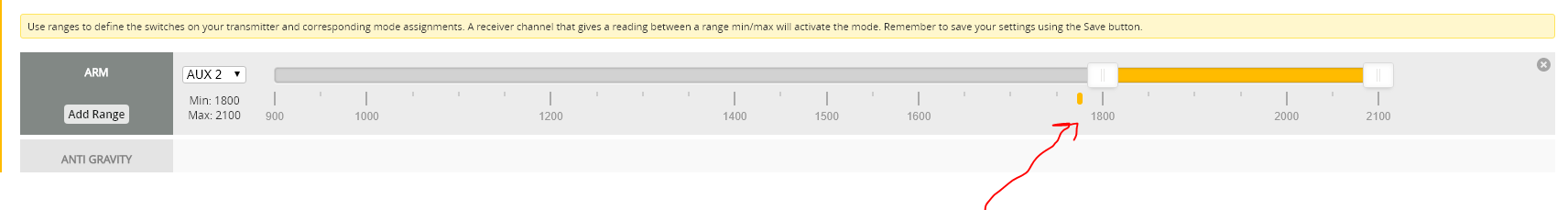

just to confirm… your Betaflight configurator - Receiver tab looks like this…
Also how does your arm switch look?
Does the little notch move then you move your arm switch and when its armed does it move into the right section?
Somehow I got range to arm aux1 min 1075 max 1475, but when throttled down motors still going and can’t disarm with stick, this is killing me!

Thx 4 your response, I finally got it to arm by using my channel 5 ( aux1) programmed to switch, I did change small angle from 25 to 25-180 so it would arm in any position, I don’t think I needed to do that and will change back to 25, thx again
leaving small angle at 180 will allow you to arm no matter what angle your quad is in…

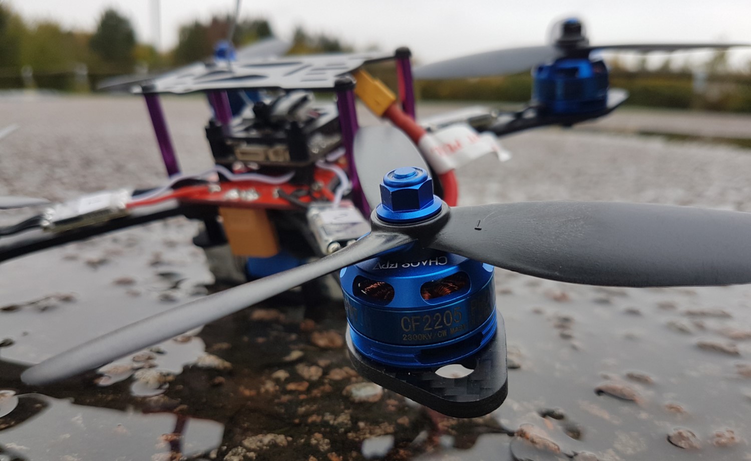

Unfortunately maiden flight FAILED, unable to attain lift, I thought if roll, rudder and yaw were neutral applying throttle would lift straight up, it tried but didn’t get off ground, if in air I think roll, yaw, rudder would work, seems not enough power
no lift…?
Check your props on the correct way and your motors are spinning in the right direction.
Take a picture of your quad from the top with the props on.
Front on and Rear on. At a little bit of an angle (Hope that makes sense)
Your motors should spin inwards
