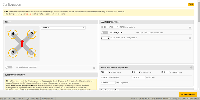

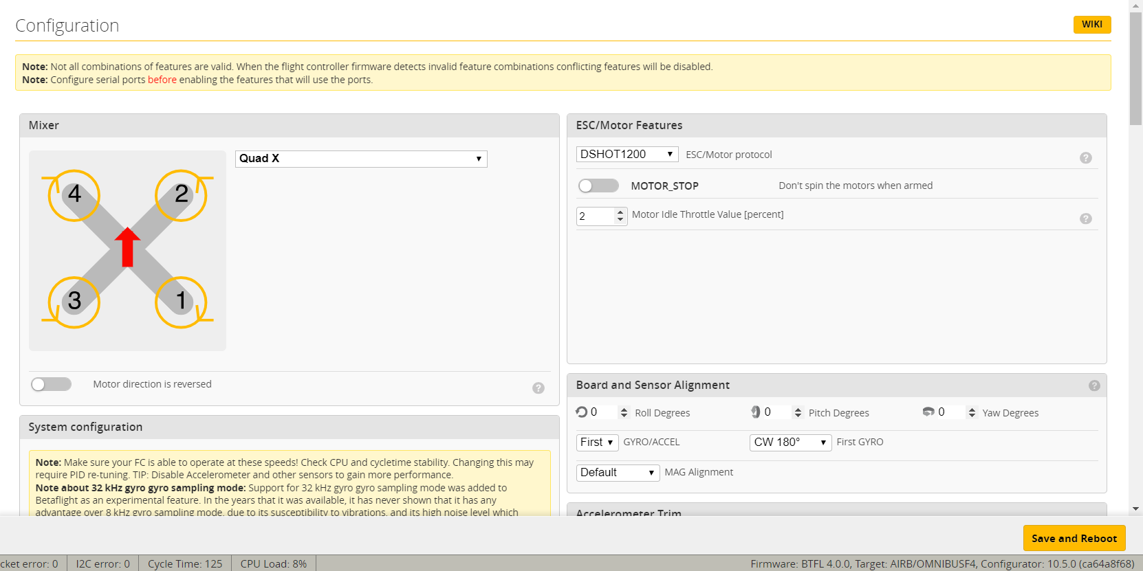

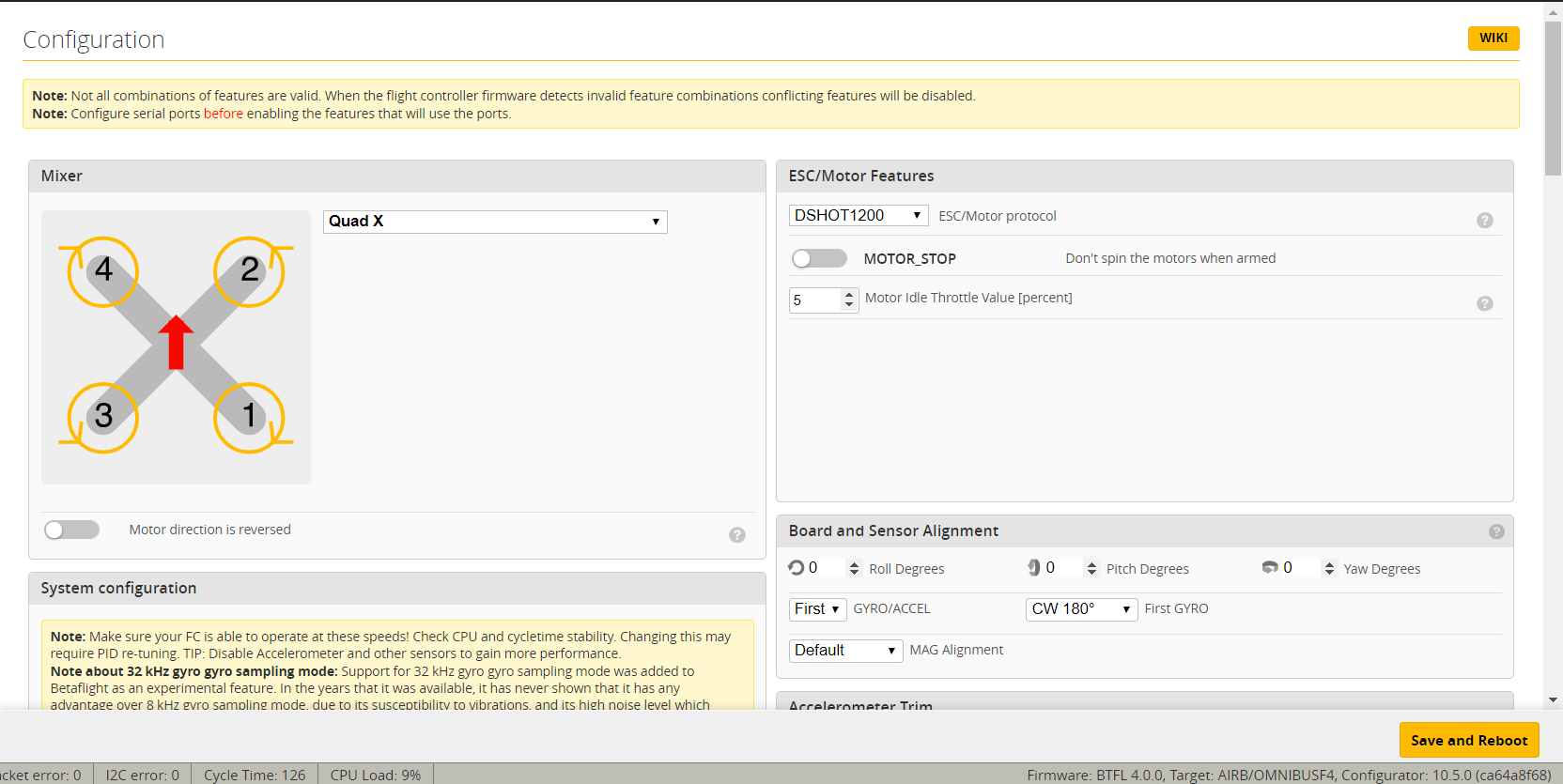

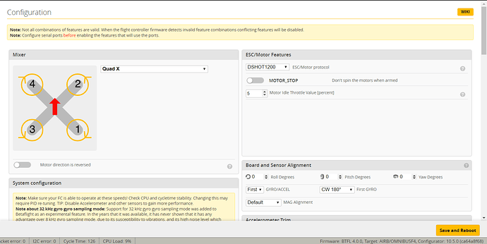

Hi, I just updated my Emax mini magnum 2 stack to betaflight 4.0. When I arm it seems that the throttle value is too high because the drone almost lifts off the ground. The weird thing is that when I flip it into “launch mode” and then arm, there is no problem at all. I have tried setting the motor idle throttle value down to 4% instead of 5% but there was no difference at all. I have also tried to calibrate the esc even tho its a 32 bit.
i have included a video showcasing this problem below, and a picture of my configuration tab.

I have just tried setting it down to 2 percent, but the same problem still occurs
