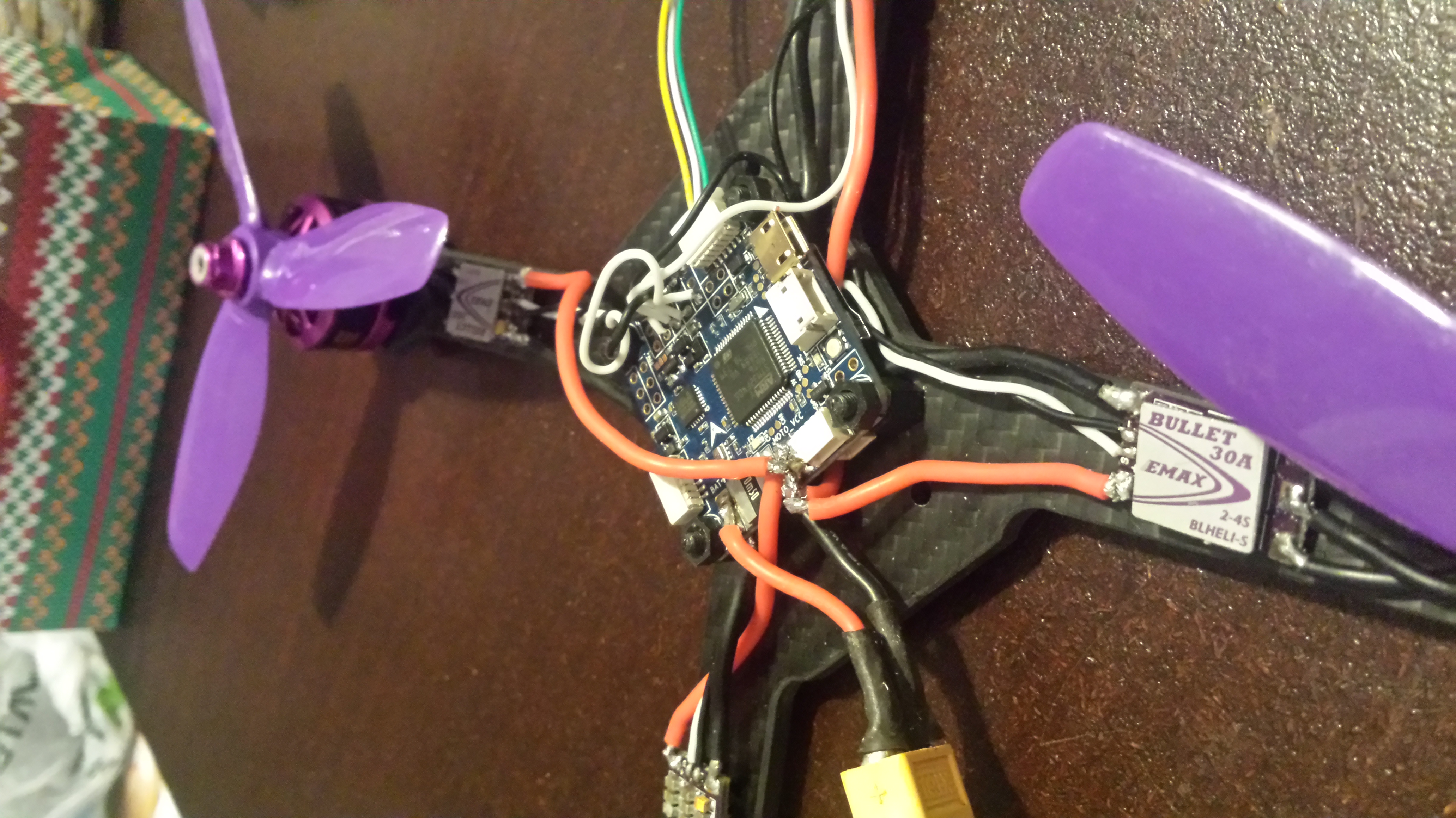

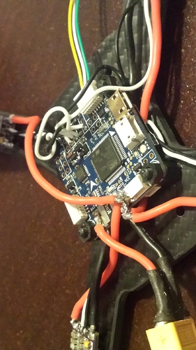

Am i seeing it right that everything is connected to the battery pads on your FC? :smile:
Yes that is right. I can do this:)
Looks more like you cant do it… :smile:
However:
My Theory is that (as @unmannedtech said ) that you dont power your FC correctly.

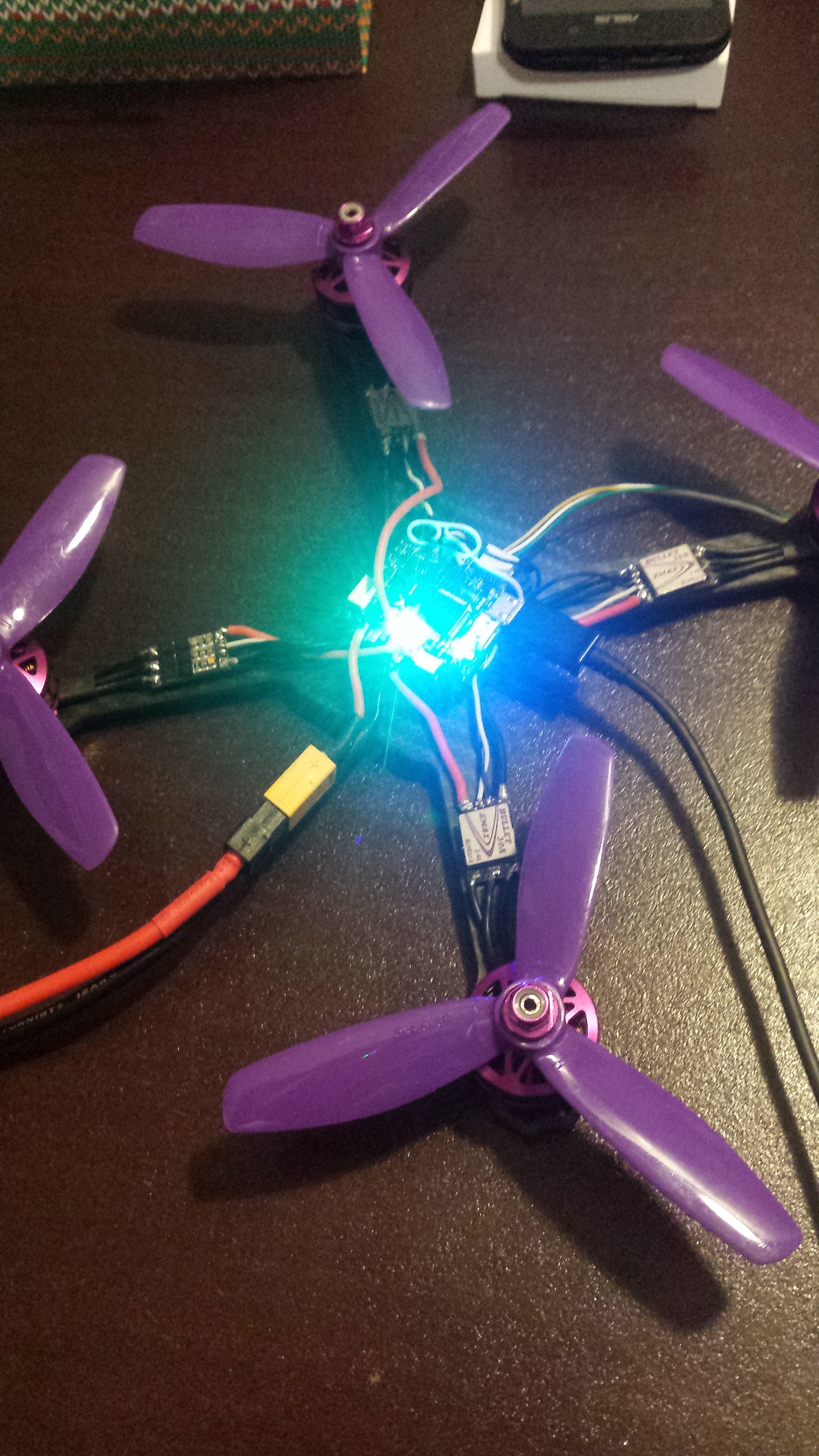

It turns on while the usb is connected because the cable powers the fc.

You really really need to fit a PDB.
your running 4 30amp esc’s off the same pad with bad solder connections that may come lose on a crash and cause a short.
If those motors even try to go full current through that connection its going to go bad, real fast.
Moving the ESC’s to a PDB will give you much better and safer connections.
