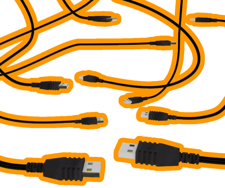

Issue 1 - USB Port/Cable Issues
Something I see fairly often is that there is some physical issue with the USB port, or USB cable, its a relatively trivial issue but its always worth double checking.
Solution 1 - Check USB Cable
First things first, let’s double-check the cable itself. Try using the same cable with another USB device to make sure it’s working. Keep in mind that some cheaper USB cables are power-only and don’t have good data lines, so it’s always best to use a quality cable that you know is working.
Solution 2 - Check USB Port
Next, take a look at the USB port on your drone. Sometimes, the port can get damaged or worn out over time. Check for any dirt or debris inside the port and gently wiggle the cable to see if there’s an intermittent connection. If you notice any of these issues, it’s possible that the USB port is physically damaged and may need to be replaced. However, if you’re not experienced with soldering, it may be best to consult an expert for assistance.
Solution 3 - Make use USB Port Has Sufficient Power
Last but not least, let’s make sure your USB port is outputting enough power. Sometimes, when using a USB hub, it may not provide enough power for the flight controller to function properly, especially if you have other devices connected to it, like a receiver. To avoid this issue, it’s always best to use a direct USB port on your computer.
So, there you have it, FPV pilots! By following these simple steps, you can ensure that your USB port is providing enough power to your flight controller and avoid any potential issues.
