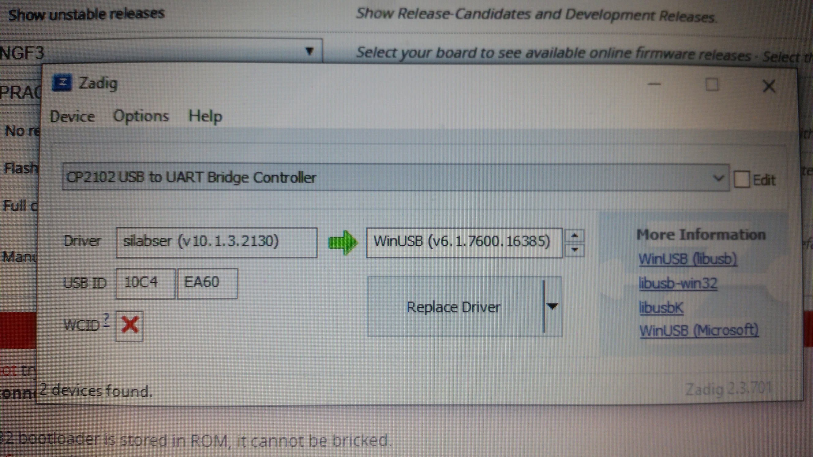

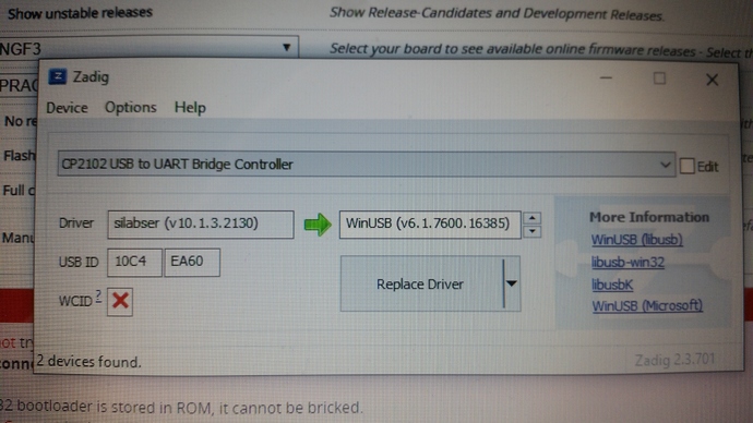

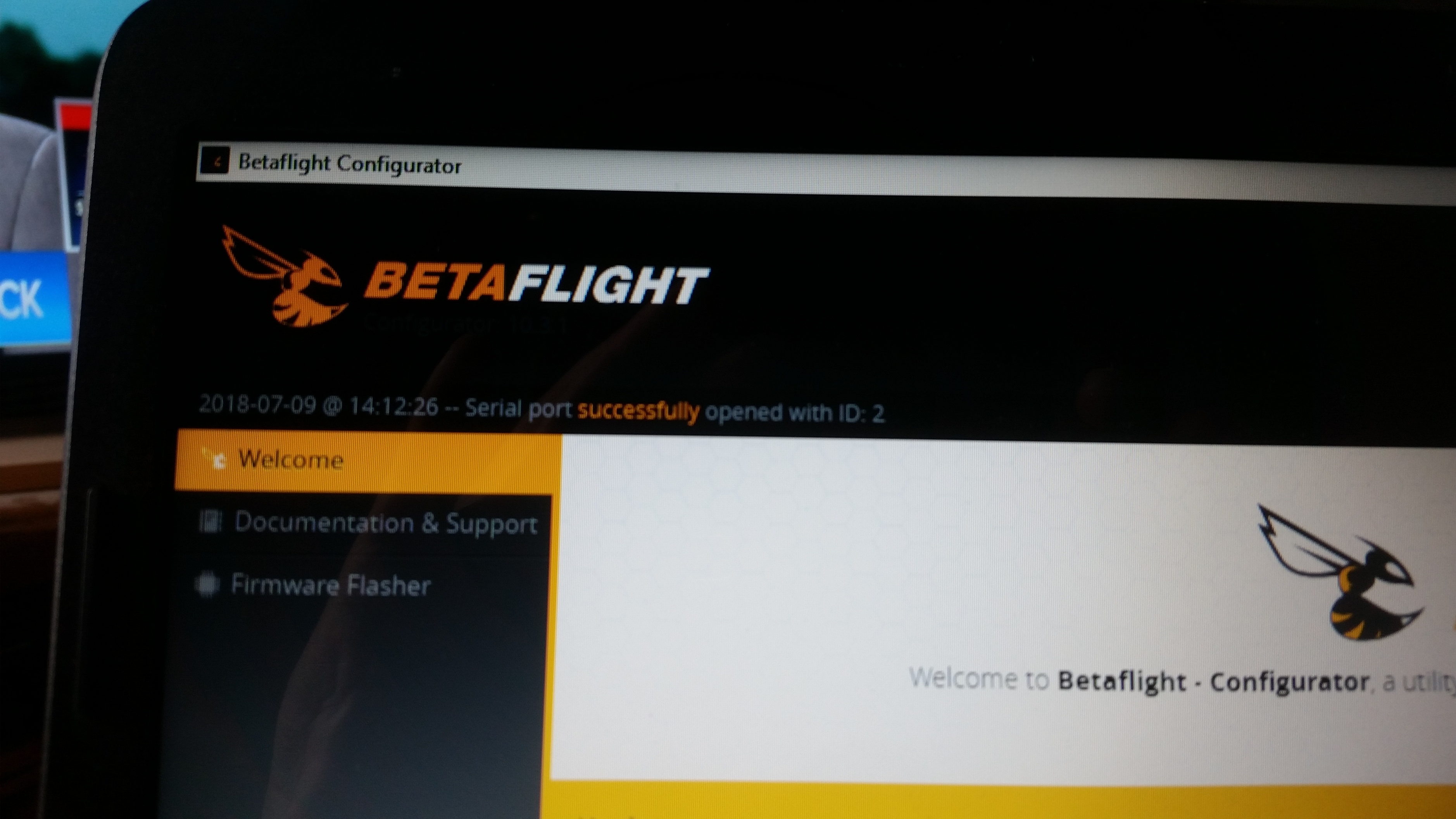

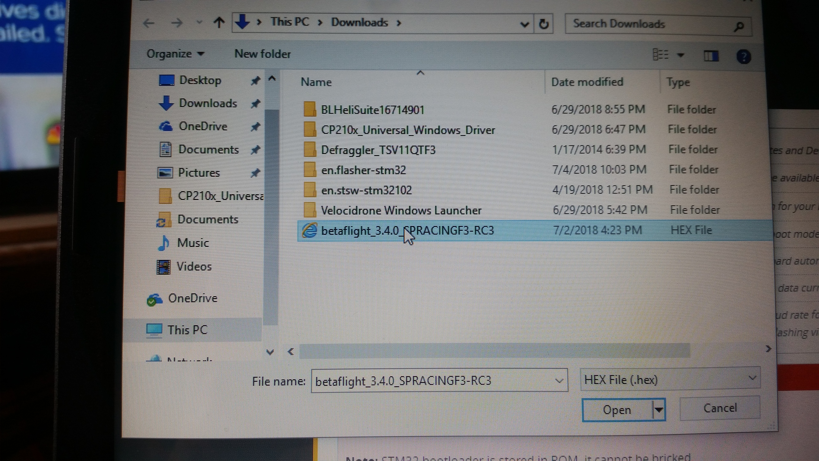

Really need help, spracing f3,solid blue, bootloader prob, I’ve looked at most videos, NO RESPONSE FROM BOOTLOADER, PROGRAM FAILED, tried zadig fix but they say I should stm32 bootloader in drop down box I have cp2102 USB to uart bridge controller, also I show com4, when I push connect it says serial port success open and close but still no connect to bf also r impulse driver fix won’t connect
Have you tried the driver fixer program here?
Yes I looked at this site, rcimpulse driver tool won’t connect,
I’m not a drone expert but go through this video and make sure you did everything like in those steps they demonstrate:
It was very helpful to me.
