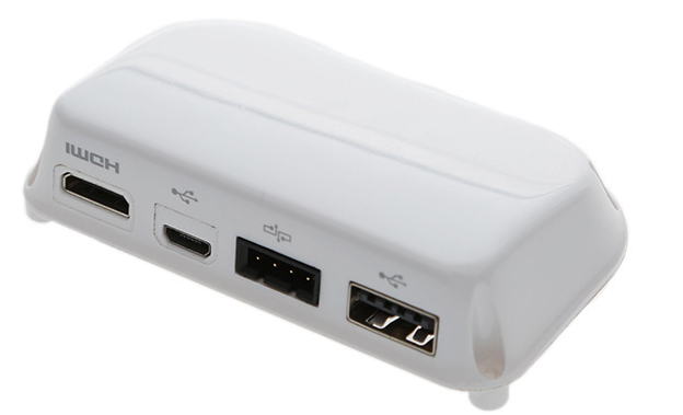

The Headplay goggles can be used easily with the Phantom 3 Professional or Advanced.
All you need is a Phantom 3 - HDMI Output Module that fixes onto your Phantom 3.
This then allows your remote controller to output to an HDMI device such as the Headplay goggles. You will then also need a mini HDMI to mini HDMI cable to connect the two together. Just make sure that when yyou are buying one to ensure that it is small enough as some larger connectors cant connect properly into the headplay HDMI input.
Hope this was helpful.
