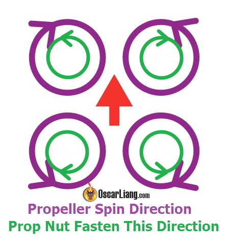

make sure the motor direction is correct, EG on betaflight config tab you can set motor direction. normal unchecked or reversed. 90% sure thats the problem.
First I check the motors and escs and than I bought new, but problem is the same. Motor spinning is correct, because one day I changed the wires on two motors. And than there are just PDB board, FC matek 405 STD board and XSR-R receiver (I added new anntenas). Is maybe the problem in ribbon cable betwen the PDB and FC?
in slow mo hard to see but both your left motors seem to spin clockwise on both right motors seem to spin anti clockwise. please triple check motors. the fault your are getting im sure motor direction incorrect.
defo not the flex cable
mini-quad-motor-direction-propeller-direction-rotation-spin
My motors are spinning like this…
and just to confirm that is the same direction in betaflight config page, you havent accidentally clicked the reverse motor tab.
it doesn’t actually spin motors the other way just tells FC to switch YAW around and that problem you are getting LOOKS like a YAW problem to me.
yea, finaly I solved the problem. It was wrong order spinning motors. thanks for all help. Regards
