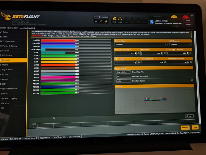

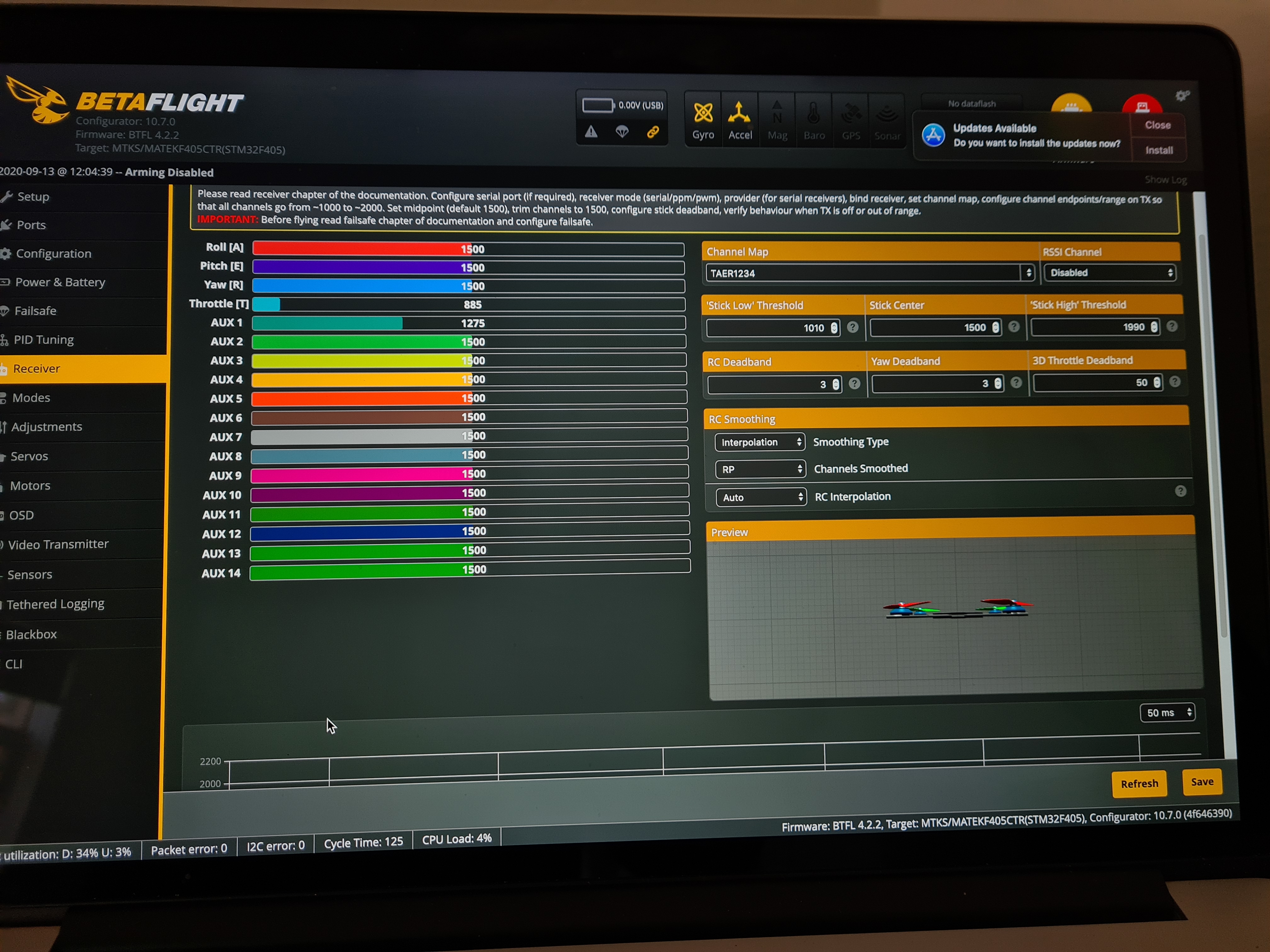

Can you send us a screenshot of the Receiver tab please?
Also try again to calibrate the accelerometer.
