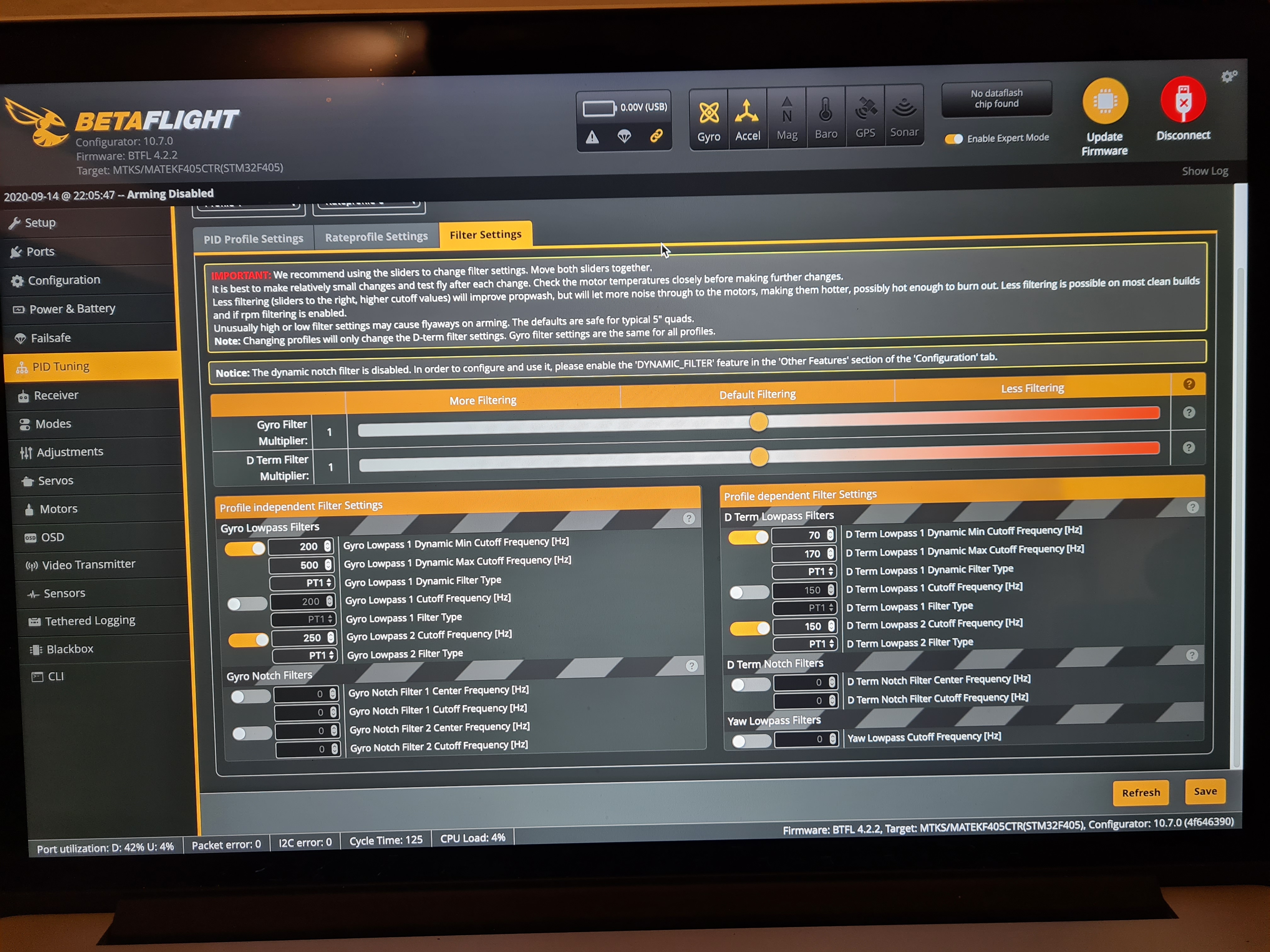

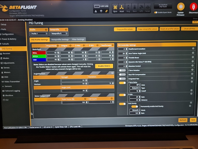

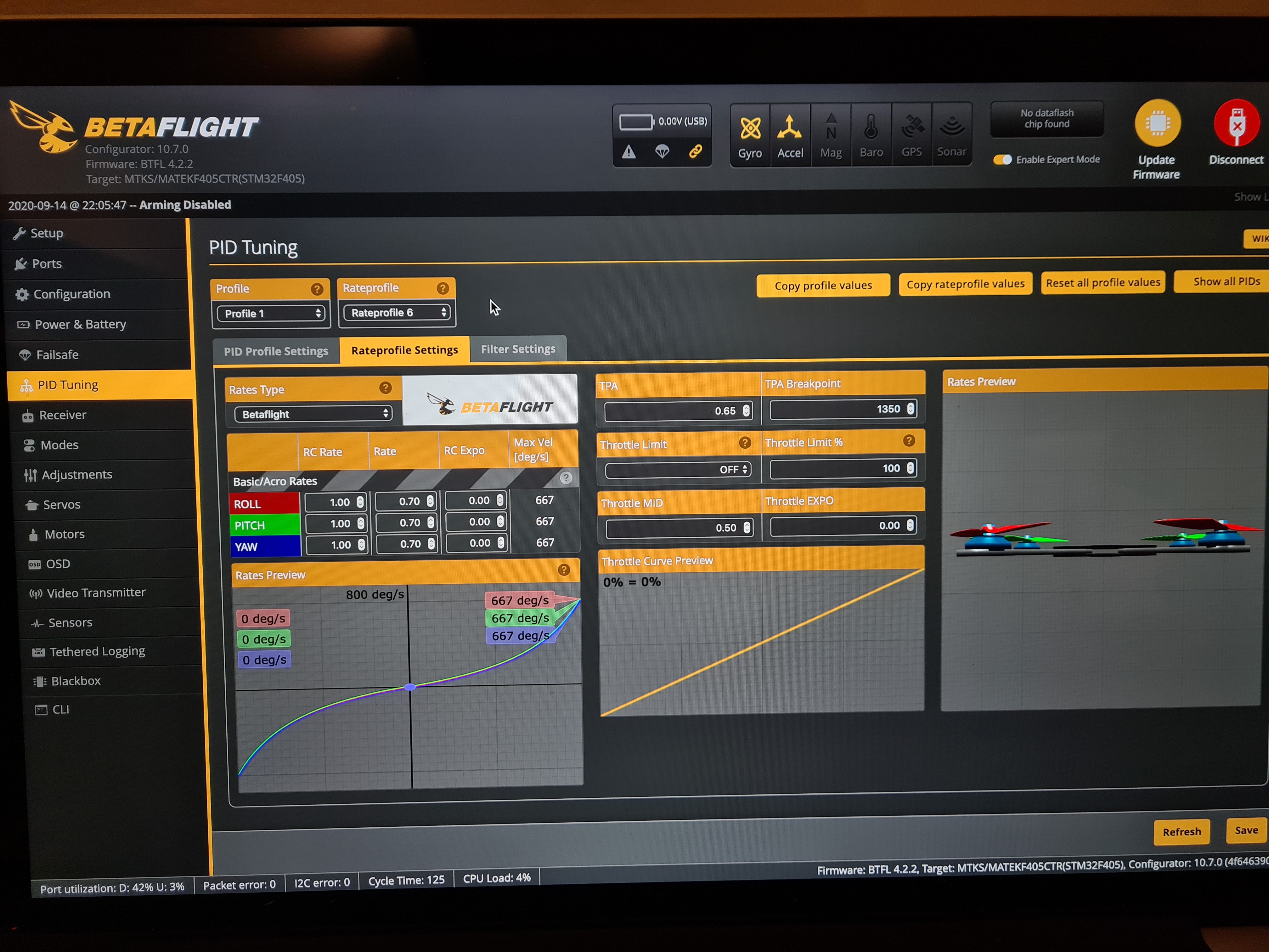

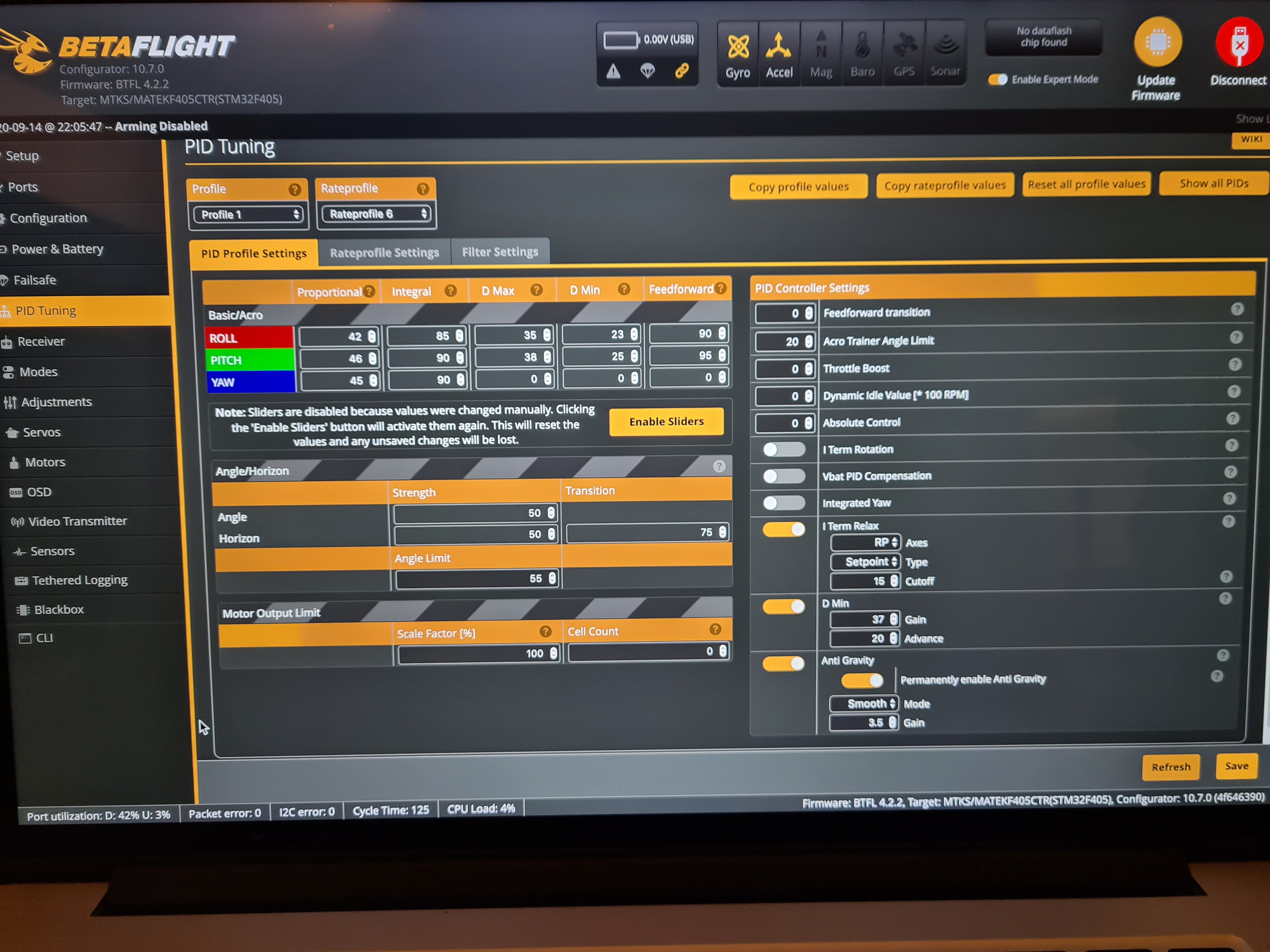

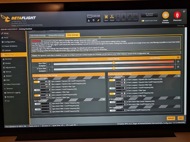

I would make note of motor protocol, serial settings for receiver and FC orientation then load defaults and try setting up again manually. You have potentially copied a setting that isn’t happy with 4.2
After that if its the same try these settings
I will get onto that, thank you!

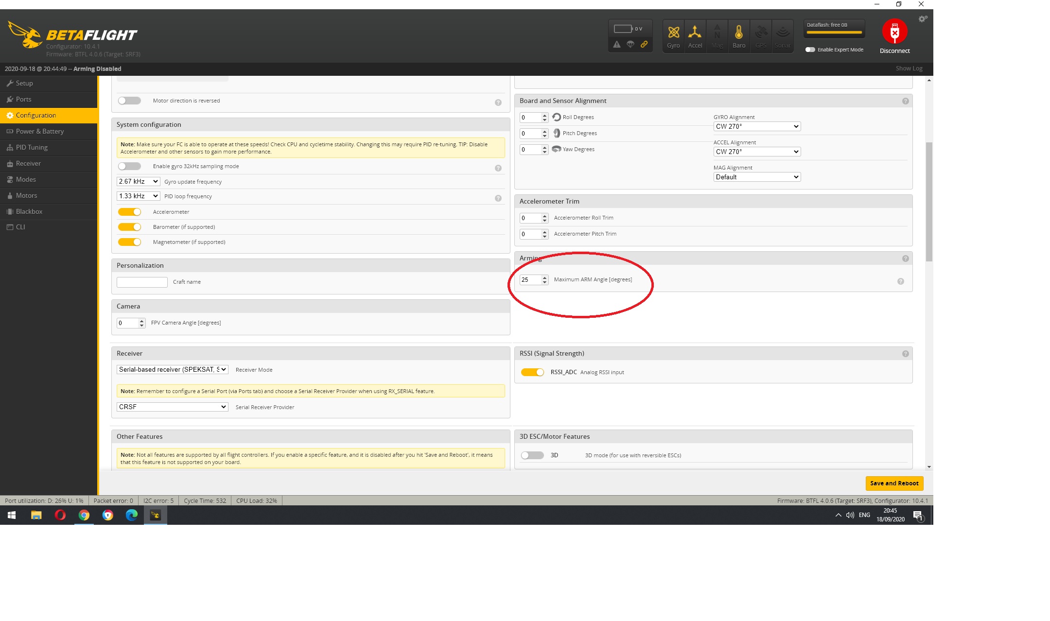

Ok so I found something interesting, when I arm the quad the accelerometer thinks the quad is pitched forward, any idea what that is?
calibrate accelometer while drone is flat on table , you can do this either by betaflight setup page ,first page that opens, or just power quad and transmitter up and at the same time move the left stick up and to the left and the right stick down, make sure quad is flat the LED on FC will flash fast when calibrating. you only need to move sticks to the said positions for a second.
also if you have battery at bottom and the quad tilts above 25 degrees it wont arm even if calibrated, well not in sissy mode anyway.
if the arm angle is set to 25 degrees its a good idea to set to 180 degrees this help to remove quad from trees because it will arm whatever direction its pointing
i calibrated both ways and shows accurately until the drone is armed and the motors spin up, then I automatically pitches forward
