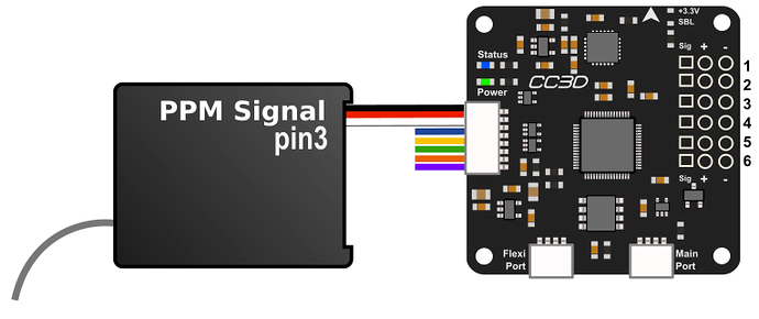

Have you checked the hardware tab to manually select your receiver port to be PPM mode? And that you RX is connected to your cc3d board as shown in the picture below?

Yes I have manually selected ppm in LibrePilot. I chose the ppm with no oneshot and it is wired correctly.

As for the receiver, yes I’m very sure it’s connected to channel 1. I tried connecting to channel 2 just to be sure and the quad wouldn’t even chime on till I put it back in channel one

First off, the wires coming off my cc3d, I needed to release the signal wire from the connector and move it all the way to the end into pin #8.
Now go to LibrePilot, configuration tab, hardware, and make sure the cc3d is set to PPM_PIN8+OneShot
Now check the Output tab and set 1 (1-3) & 2(4) to PWMSync. 3(5,7-8) & 4(6,9-10) will be PWM.
Once all that was set I had no problems!
