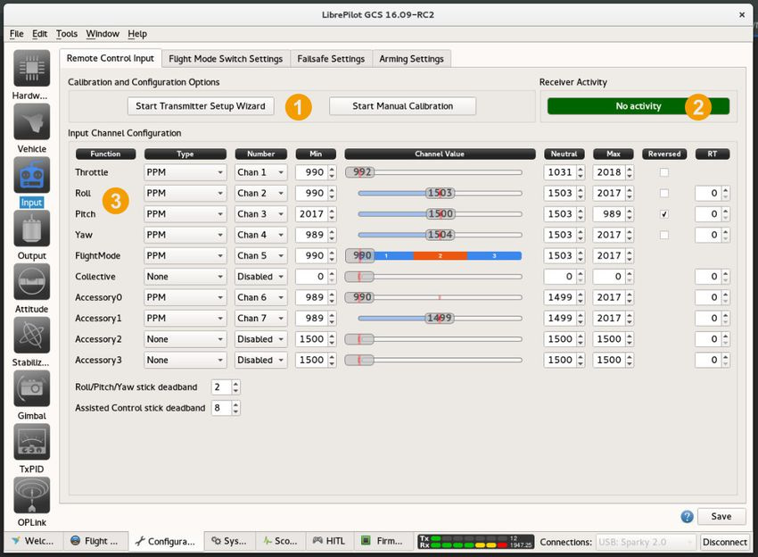

The issue this time is when I start the Tx Wizard I get a message ’ no RX activity ’ , true there is none visible on the wizard and also when out of Librepilot using Tx Rx nothing happens.

You might want to go to the Configuration Tab to manually set the inputs to be PPM, and on this tab you can also check if CC3D is reading your receiver correctly

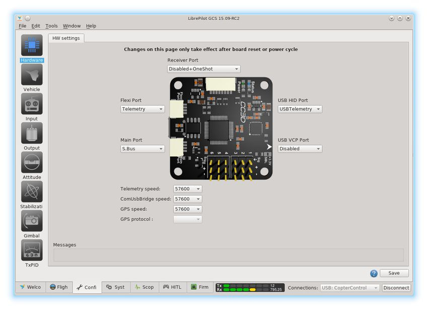

Also I would also try first connecting PPM to pin 3 just to check that is working, and then move to pin 8 if you want to use oneshot and also check the receiver port configuraiton on the hardware config page
