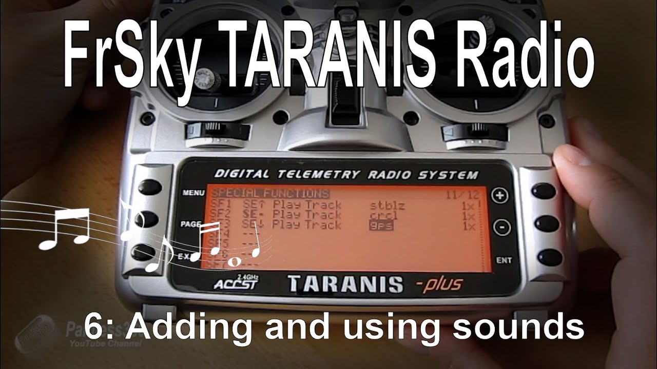

Here is a great video tutorial that will teach you everything you need to know about sounds on your taranis, abit long but worth learning if you want to add the sounds, and the best sound pack to use is the Amber sound pack for taranis
Hi, thanks for the reply.
I’ve already loaded the Amber Soundpack, and it’s working well.
I’ve watched pretty much all of Painless360’s videos (including this one) - he’s a very useful resource.
Unfortunately, this is only for the X9D with the F_Modes selected either by two switches, or with the 6 way stepped pot/switch plugged into position S3.
My X9E doesn’t have S3, so I have put it on a spare pot channel (F3) and calibrated it.
The switch operates the Pixhawk F_Modes correctly via a custom curve, the problem I’m having is how do I assign the various PWM values (or percentages) selected via this curve to the Special Functions for each voice file?
