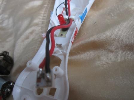

Hello all. I was given a Syma X8 which wouldn’t fly. I tried to fly it without success. It appeared that one of the props was not revolving.
I had assumed that one of the motors had failed. I used the mm to test continuity and all wiring seemed OK. I then tested the suspect motor in another motor connector. It was fine. Using the transmitter (obviously) I tested all four motors in all 4 different motor connectors, but one at a time, individually. They all worked fine in response to the transmitter. I then connected all four motors to their prop connectors (being very careful to make sure that A’s and B’s were in the right place), but leaving the quad top off so I could observe the shafts.
Turned on the transmitter, then the quad. On this quad you arm the motors by turning the left stick to the bottom position, then the top, then bottom again, and then going upwards again, the motors arm. And so they did. All but one. I moved the stick very slightly upwards more. The still motor started. Moved the stick to centre. All 4 motors going. Moved the sick north more, motors accelerated and then two of them stopped.
I repeated this 10 times with the same result.
I am assuming this is a transmitter fault. What do you think? Some photos attached.Syma 1

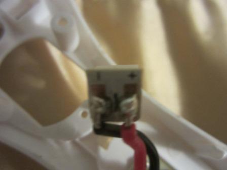

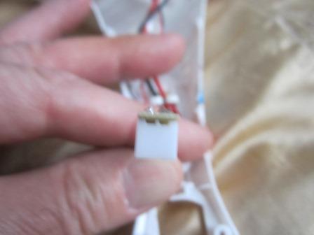

After having done a little studying and watched a few youtube slots for electronics beginners, I wonder if you could clear something up. The leads to the 4 motors terminate in aESC 1 small square insert with a + and - that slots into the connector that the motor connectors marry up to. See photos. Are these the electronic speed controllers?ESC 2
I don’t think they are speed controllers.
ESCs take a DC input and signal wire and convert that into 3 phase AC for the motors.
I only see two wires which to me indicates a DC motor (also looks geared)
so all the control is probably on the main board.
Thanks DoomedFPV.
I am very much in the learner stage and appreciate all replies. What function do you think these small square inserts serve?
I know the quad in question is a cheap, unsophisticated model but I suppose you can always learn something. From the photograph of the main board and with my extremely limited knowledge, I think I can identify: 3 capacitors, a couple of transistors, several tiny ic’s, and what I believe are 2 heat sinks. If this is correct, will the esp’s to the 4 motors be somehow incorporated in the ic’s?Circuit board compressedConnection compressed
