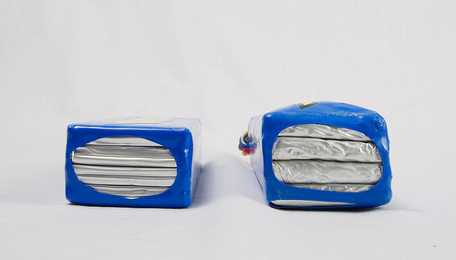

First thing to check is to see if you lipo is puffy? If it is then I suggest you dispose of it and get a new battery as puffy batteries are an early sign of them becoming unstable. The puffy lipo is on the right.
