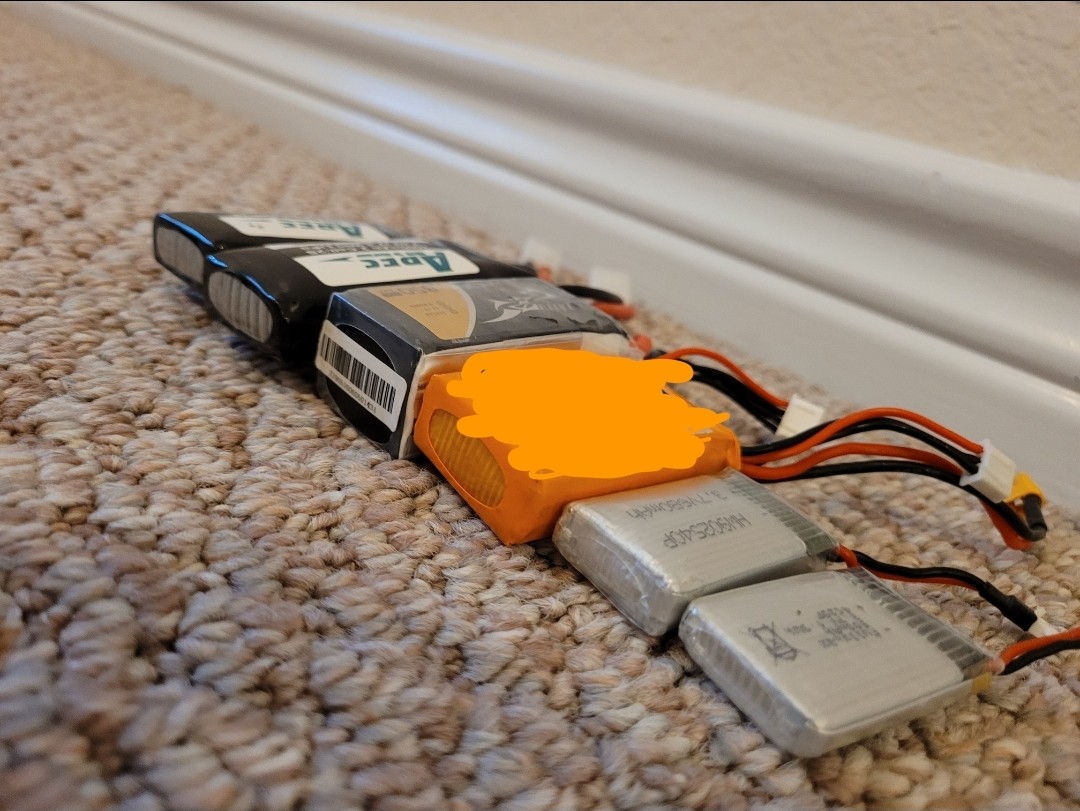

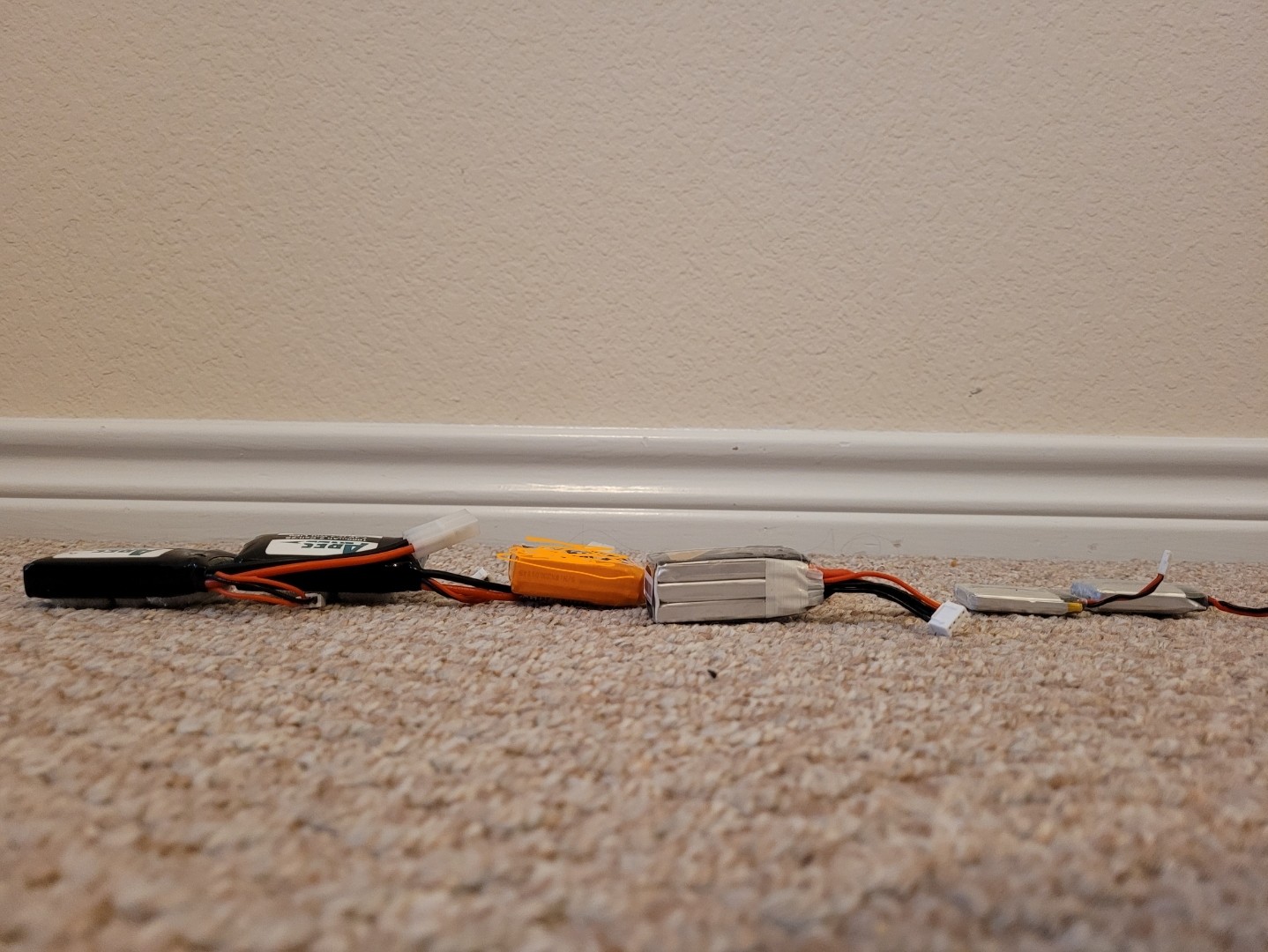

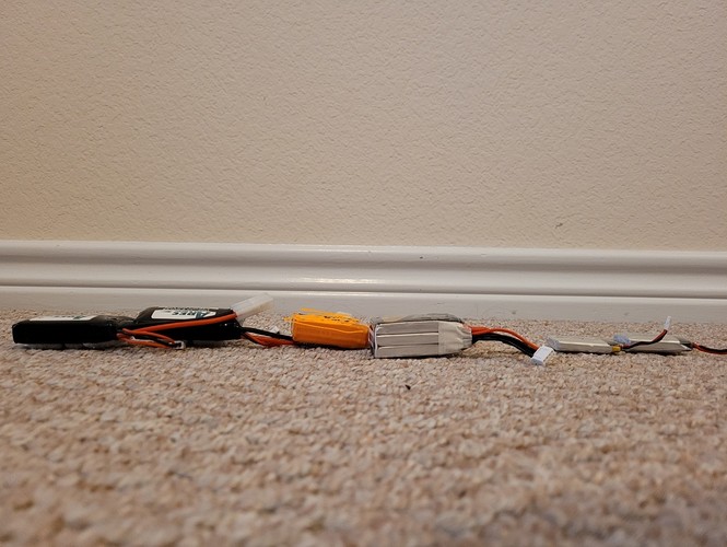

So I’ve never been the person to care about the wellbeing of my batteries(which I should have) and now that I know the dangers of puffy batteries I’m starting to realize how naive I was. The problem is, I can’t tell which of my batteries are puffy since I got them all a while ago. They’ve been through months being fully charged and some left in a hot car.
Yes, most of them look a little puffy. For general safety it’s good to store them in a metal box, but the most dangerous time will probably be during charging so don’t run off to the store.

Anyway, are they puffy?, Yes.
Are they dangerous? Not necessarily.
What should you do? Store them around 3.8v definitely not at full, keep an eye on them to see if they get substantially more swollen, and don’t run them below 3.4v during use.
