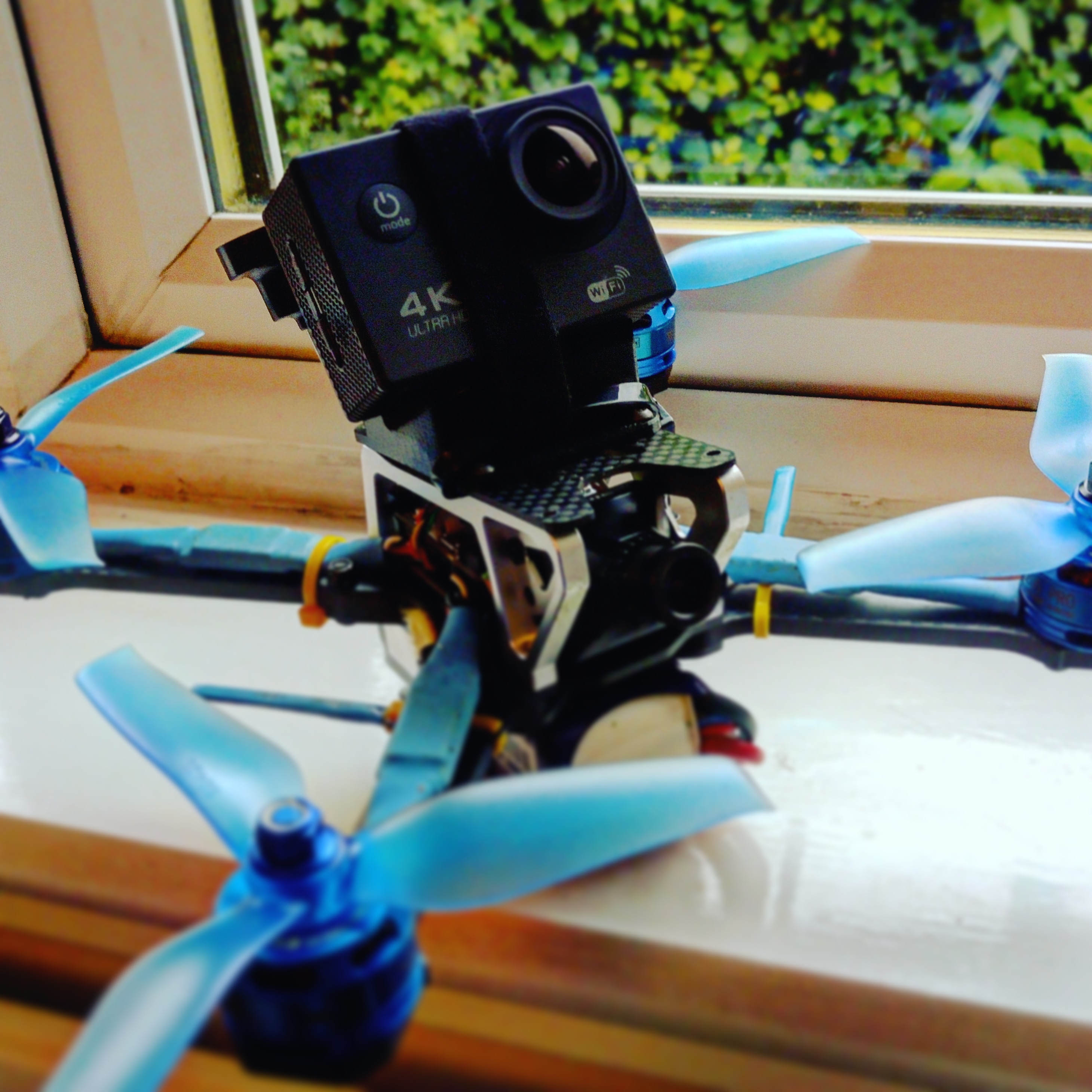

My quad has changed a lot over the course of about 9 packs. SOOOO many crashes! My cheap and nasty 4k camera is lost to the woods somewhere. I hope to retrieve it in the winter when the grass dies down. One of the RX antennas is a bit dodgy…

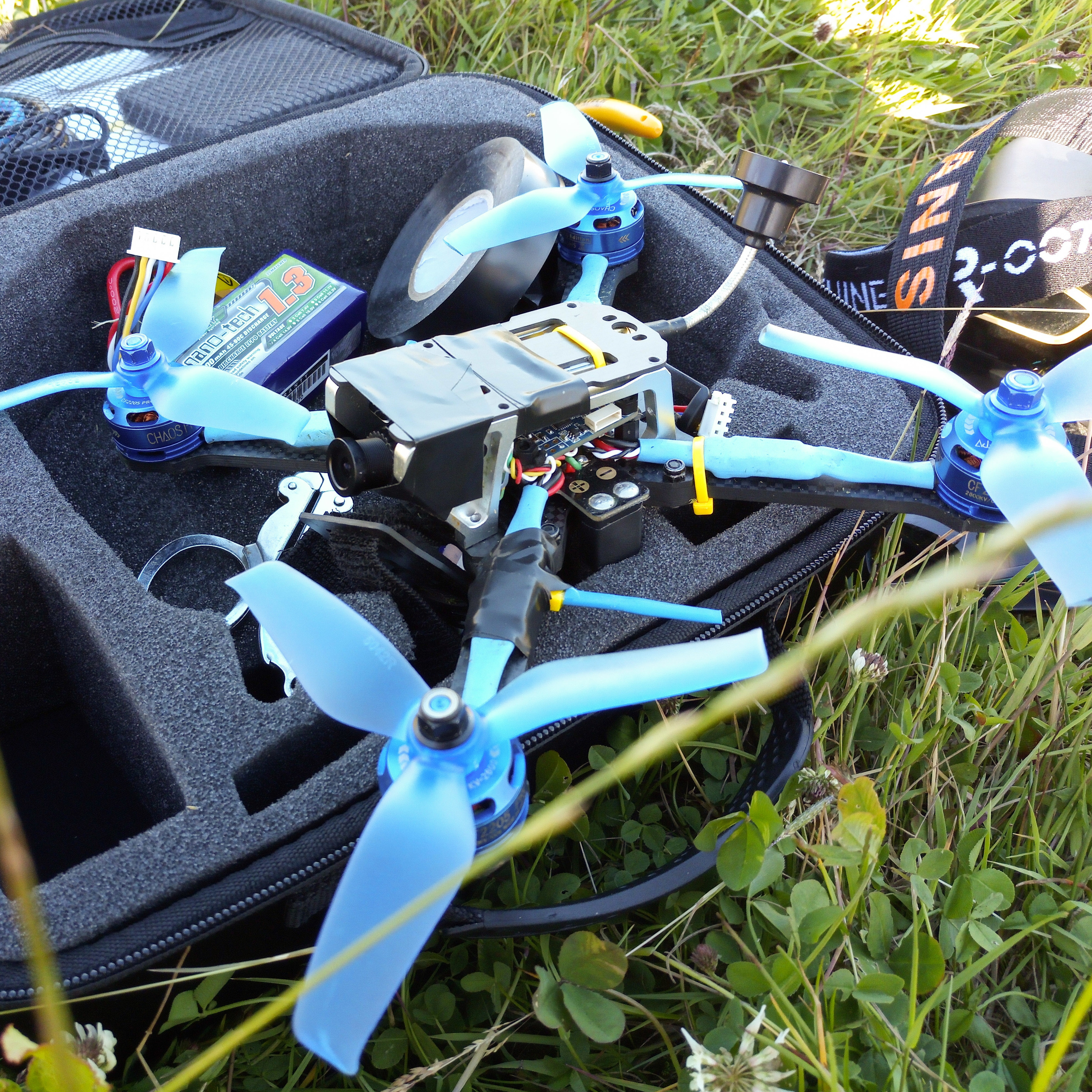

Mistakes were made… field repairs ensued…
