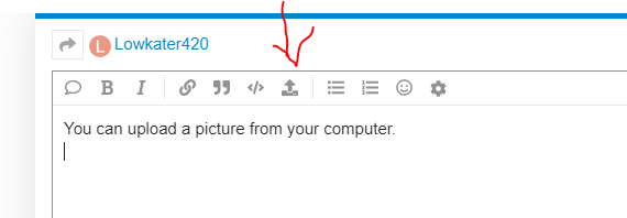

Wait how do I post a picture? I don’t see a camera button???
You can upload a picture from your computer.
or copy and paste works
Thanks for showing me how to send picks !!!
