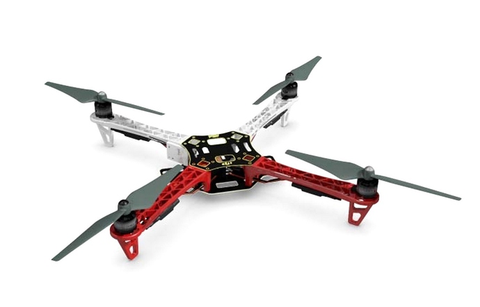

I am always in the search for good innovative frames, for the past years we have seen frames like the TBS Discovery and DJI F450 that sort of started this whole “quad” craze…

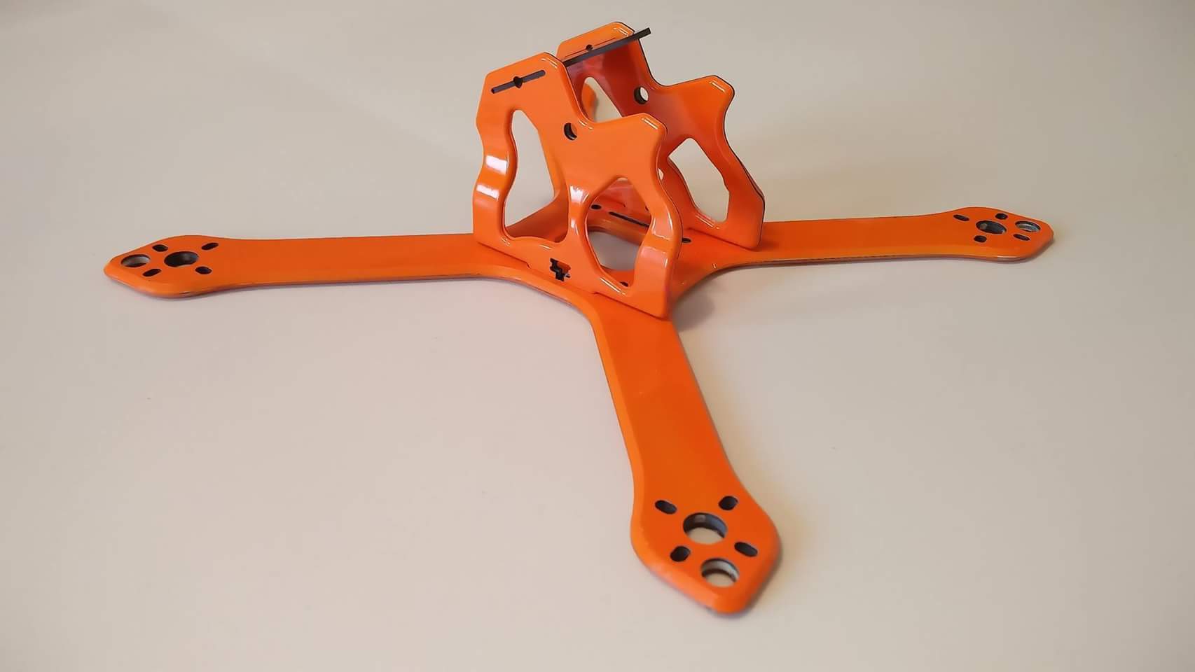

So… A couple of weeks ago i got in touch with a guy (SAMHOBBY) and started talking about his frame he posted earlier that day in a group on facebook. (picture above)
i was really amazed by the looks of it and really wanted one so ofcourse i asked him to send me one…

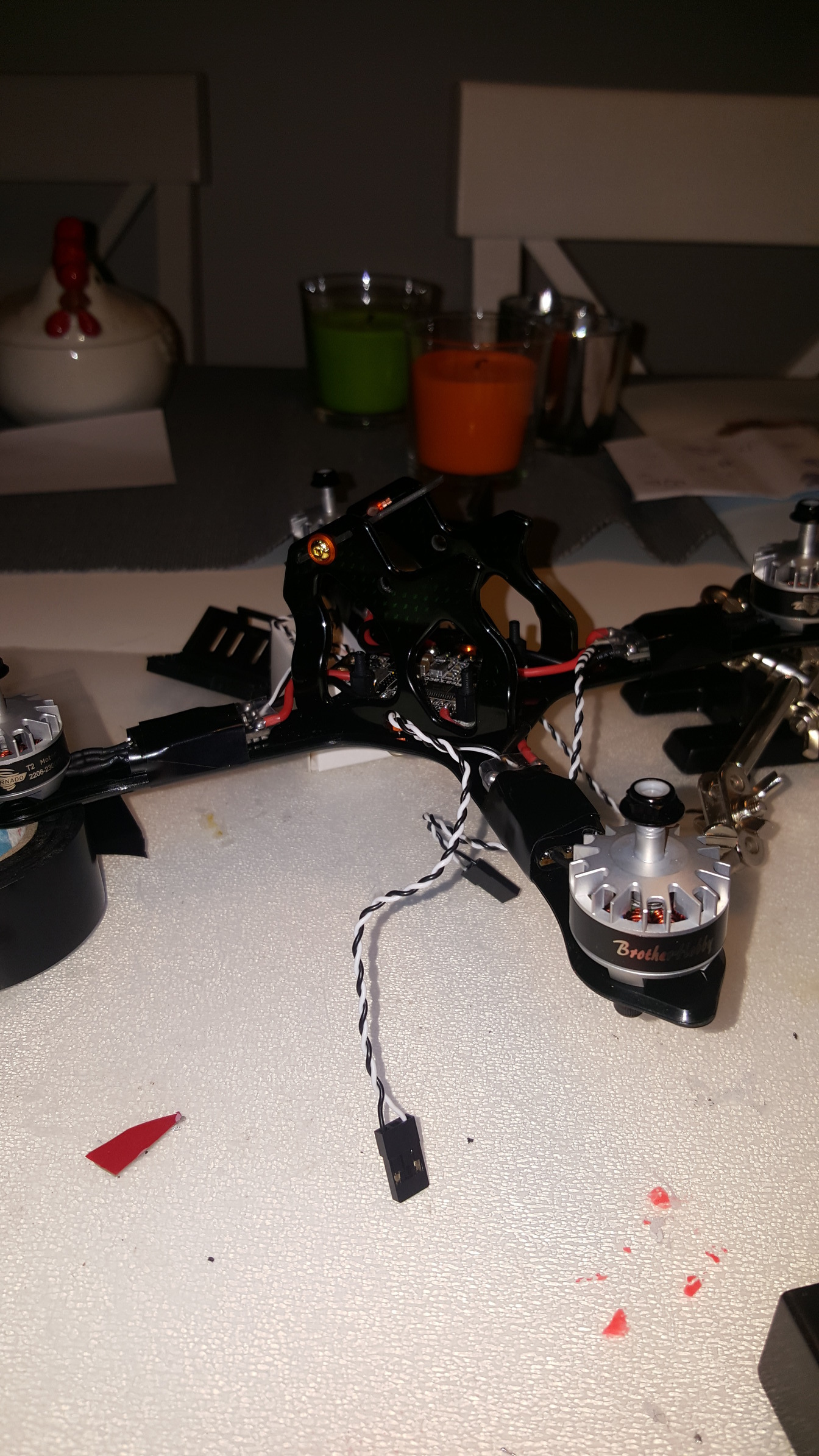

the frame i got from him is not yet flown and configured (waiting for the STREAK F4)

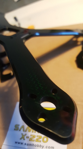

the main plate is basicly 2 molded carbonfiber plates with balsawood and carbonfiber spares inside to give it more strength. (picture below) this method of makeing the frame is suppose to “absorb” the vibrations which will make it really easy to tune and will be awesome to fly…
the other things on the frame is 2 “side plates” that is made the same way as the mainplate and one “top plate” milled from 1.5mm carbonfiber plate. all screws and nuts are aluminium. all this makes it a vey light and durable frame at only 64 grams.
i gotta say that i didnt belive in this concept from the start but once i got it i was blown away about how rigid it really is!

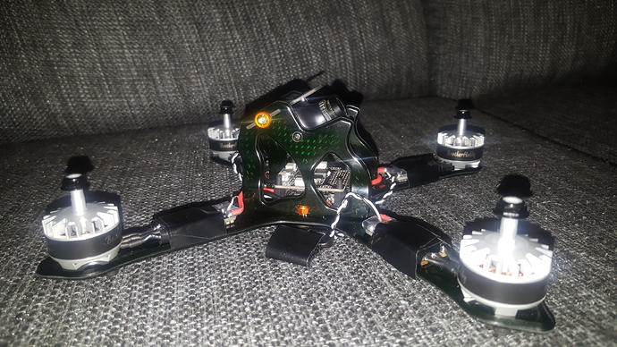

I will post more about this frame as i get my flight controller.
while you wait you can take a look at these pictures.
