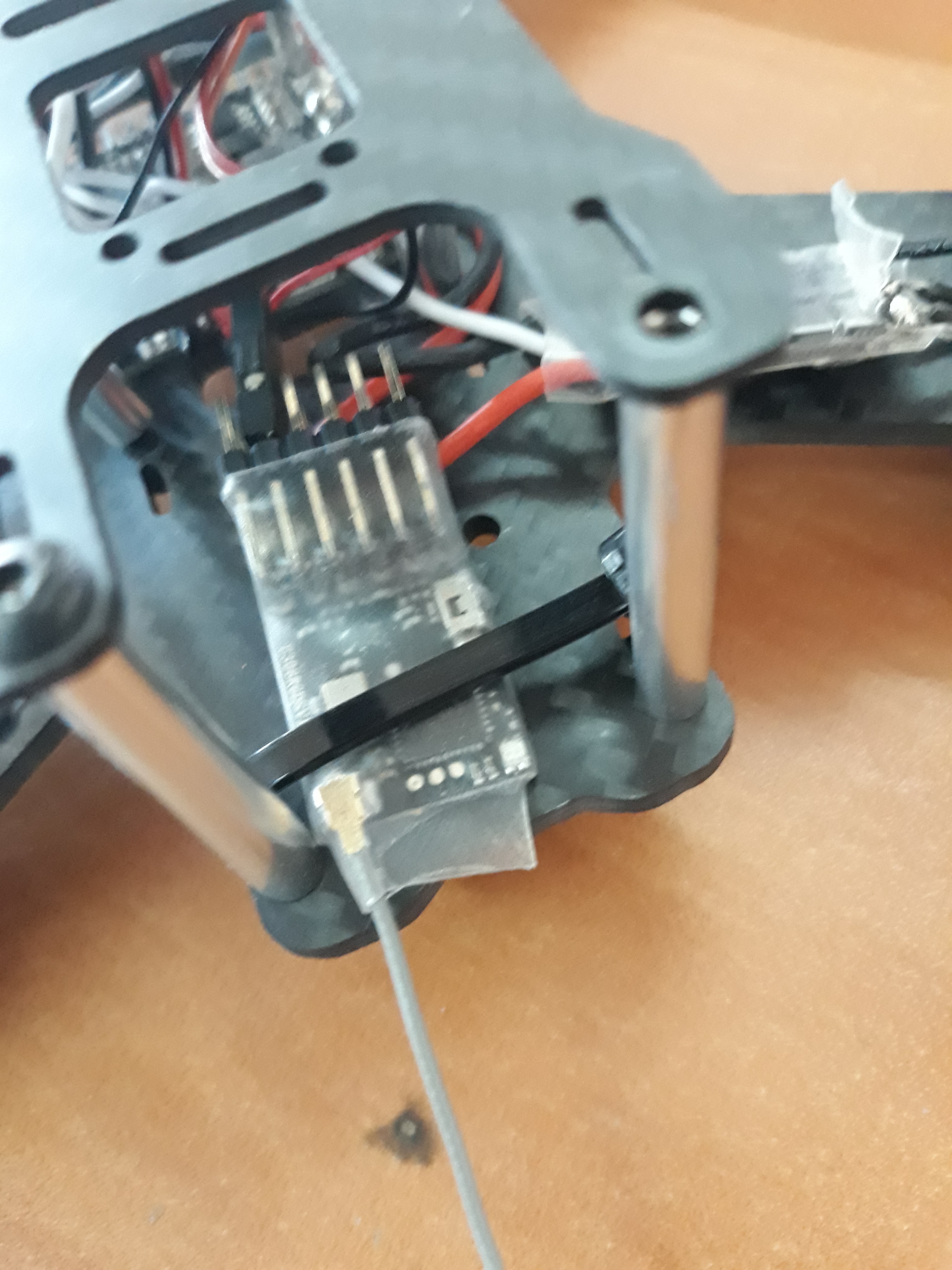

How are you antenna mounted?
Pictures?
May there be a Slack Joint ?

Try to move your RX to the back…
Maybe there is a Problem with your RX after the crash…
Double check all connections and try to swap out the Receiver if it wont work.

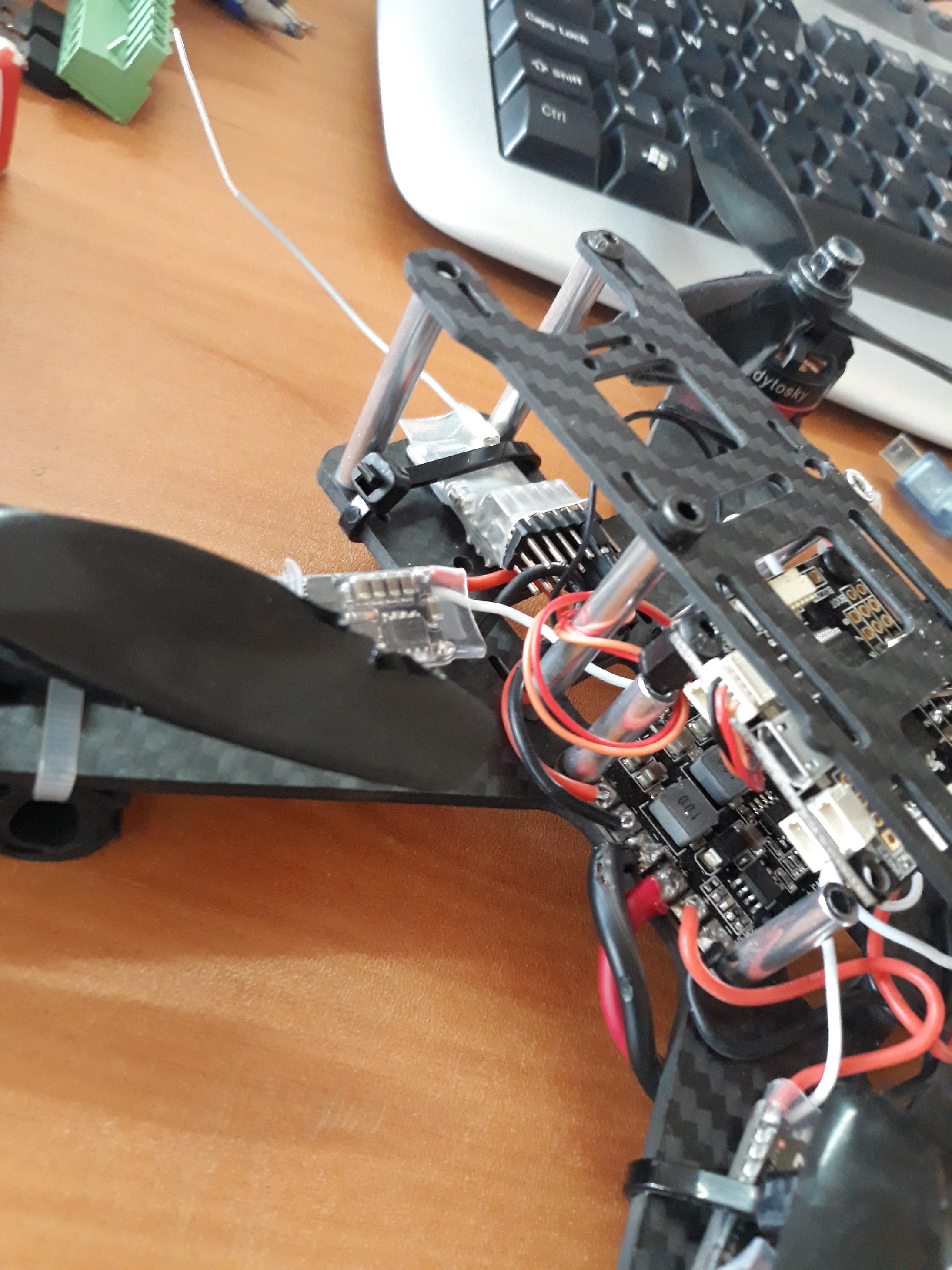

OK so a couple of things here need some work.
But it can all be fixed. :slight_smile:

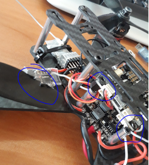

New screws - you seem to be missing some.
New top plate - yours is now broken ( but may still be flyable )

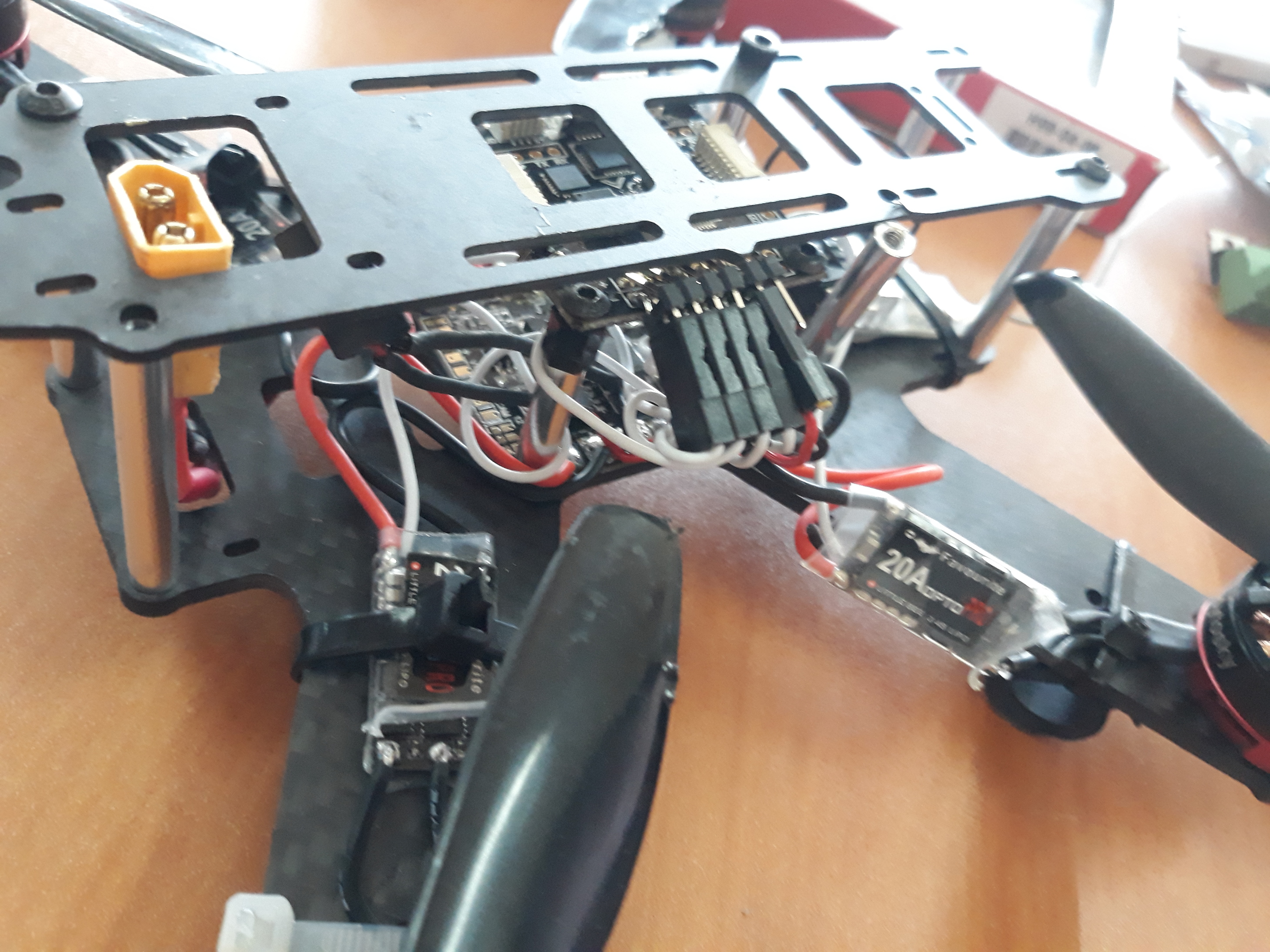

LittleBee ESC - Needs fixing back down and could do with some tape/padding under neath it to protect from shorts.
Flight Stack - swap out those metal standoffs for nylon ones. the mounting holes on a PDB and FC are some time grounding points.
Try to mount it...... Nylon stand off > PDB > Nylon stand off > FC
 Rasing the PDB off the carbon base plate will protect your from shorts.
 Refit the connectors on the FC
RX - refit the connector there too, relocate the RX to the rear of the frame. It will get better signal if there is less carbon between it and the TX
Bad connections will give poor conductivity - bad power and bad signal.
But as I said it can all be fixed.

Your find as well
with your damaged prop and FC not fitted down any more.
Your get a lot of vibrations transferring to the FC which could cause it to shutdown after a short time.
Fix the issues listed above and your range should return.
As suggested these issues will cause alot of problems down the road if you dont fix them
But for the range issue… I the fault is likely to be either with teh receiver of the radio itself. I would check the antenna on the reciever is connected properly as my first suggestion would be the antenna. If that looks good, the next thing would be to try use another receiver, so isolate the problem to be on the reicever or not.
The other likely cause is that the antenna on the radio itself is damaged. Sometimes this can happen if you carry it by the antenna or something causes some pressure on it., so the only way to check this is to open up the radio.
However at this stage you might want to contact the shop you purchased it from for some help assuming the radio is still in warranty.
