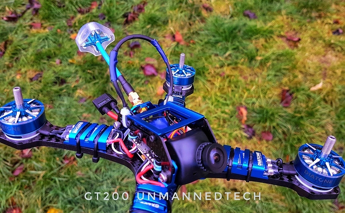

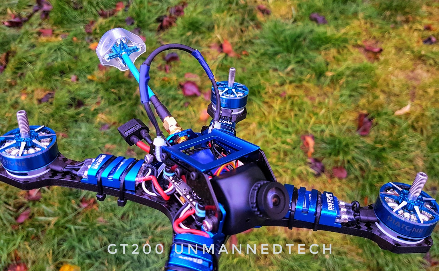

I was wondering if anyone else has a great idea on how they mounted their RX antenna on the crusader GT2, as if you dont do it right, when you crash you will probably cut them with the props…
So far here is my best solution (after a few attempts)…
What I did is use two zipties, loop them over with the RX antenna on the inside, and then secured them all together with some heatshrink… I also made sure that both the antennas are vertical (as much as possible)
This way in a crash when the quad lands upside down, neither one of the antennas will be able to be pulled into the props as they support each other.
However, if anyone has a better method would love to see it! Otherwise hope this helps…
. Then you should get good reception no matter how you are flying!
