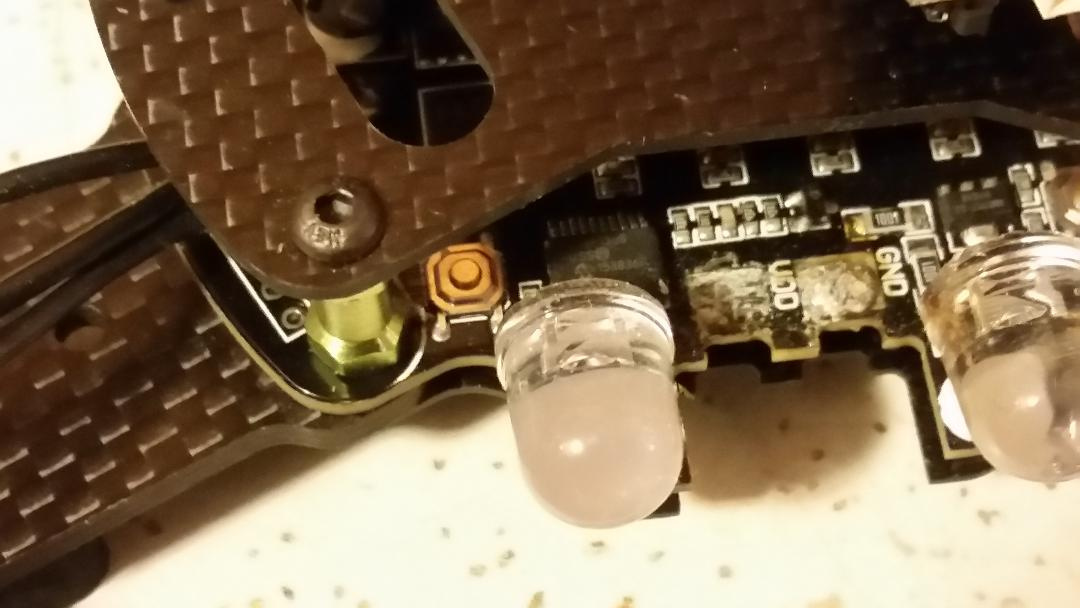

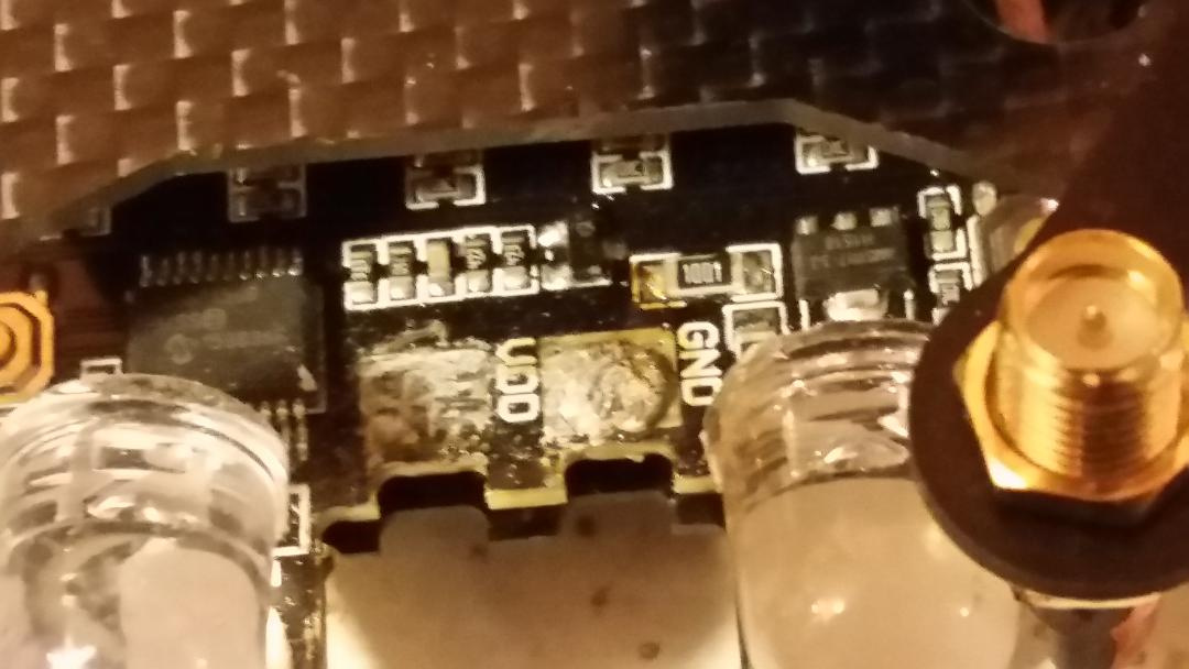

I have a 280 racing drone that lost a leg in flight and when it bounced the battery ripped all of the soldier out of the battery pads from the frame (its an integrated frame with built in fc and escs on board) I was wondering if it was possible to jumper a positive and negative wire to an esc, that would allow me to connect a battery by bypassing the ripped out battery pads. Recommendations on resoldiering accepted as well, I gave it a shot but there was nothing left to get the solider to attach to on the pad any more.

here is a pic of the pads after attempted repair.
this is the pad, the first picture shows the positive and negative wires to the esc that I want to jumper to.
The ESC wires don’t look very think and may not take the full load of the lipo.
Can you get a picture of the ESC Pads?
