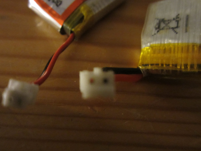

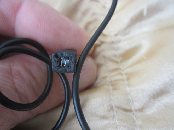

I have a confession to make. The charger is coloured black but has a white integral insert (which takes the battery terminal connector). In my stupidity, I thought the insert was part of the battery terminal connector and had got stuck, so tried to prise it out, thereby completely naffing it.
So, the battery itself is fine, I just need a new charger. Unfortunately, your link for the charger is not accessible. Here are a couple of photos of battery and terminal connector. I have looked at loads of chargers on Ebay, but am still unsure as to the right charger. (The drone in question doesn’t seem to have ever been very popular). Grateful for your advice and hope photos narrow it down.

Otherwise if you can look at the specs and let me know what that connecor is called that will also make it easy to find a charger as it’s hard to tell the exact connector from a pic. But my guess is that it is a jst-ph connector.

You are correct. It is definitely a jst-ph connector.

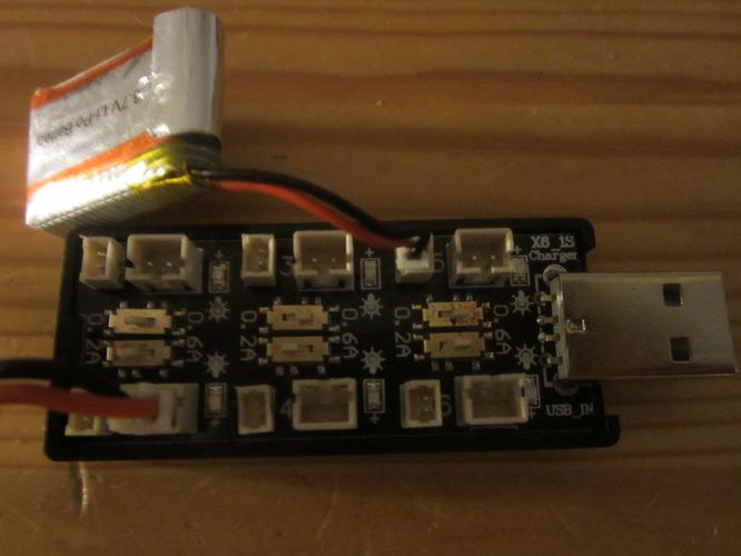

But I am not having the greatest luck on this. Charger delivered yesterday. It has 12 ports:
6 x 2.0 (I think)
6 x 1.25 micro (I think) Both of these sizes are jst-ph connectors. Is that right?
I actually have 2 different toy drone batteries, one of these fitted the larger port, and the other, the smaller. I plugged in the smaller one (the one I am actually trying to get sorted and which the photos in the thread refer to. the 1.25? ): Result: a green led light flash and nothing more, despite several hours of repeated attempts to charge, I then tried the battery in the drone: Flat as a pancake.
I then tried the battery with the larger connector (2.0?): Immediately a constant red light came on, and stayed on for 30 minutes, then went out. Then tried that battery in that drone: Result: fully charged.
So… Have I bought a charger that works on the larger port, but not on the smaller? Highly unlikely, I’ll wager. Otherwise, the battery with the smaller connector is naffed and I need to get a new one.
Photos attached and very grateful for your advice whenever you get a chance. (Photos poor I know. Can send better if this helps).

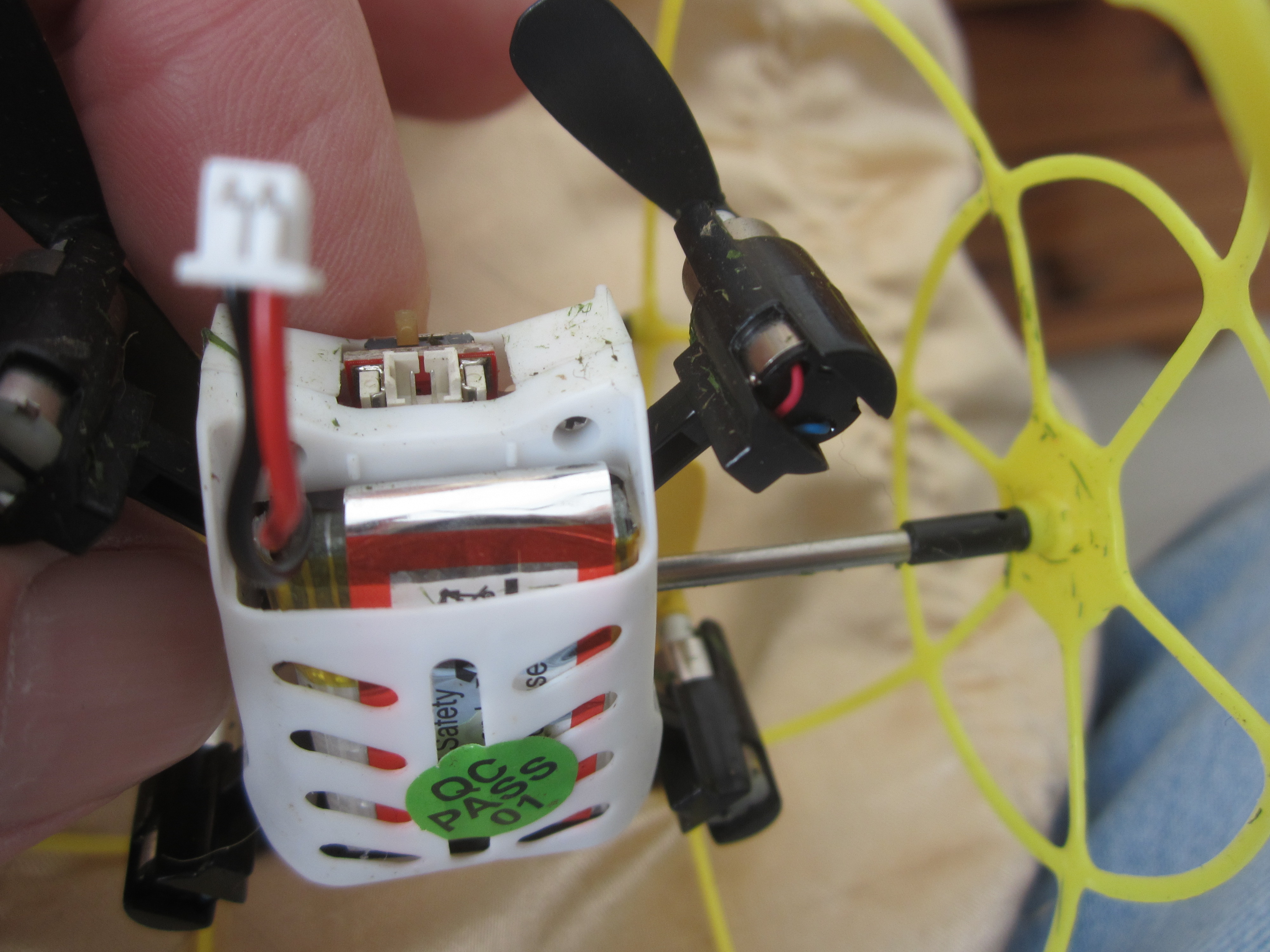

The connector on the battery is definitely a JST micro 1.25. I have scoured Ebay, Amazon and Bangood to try to source one which has the right connector and battery dimensions to fit the drone battery aperture, and believe me, these batteries are plain unavailable. There are plenty of 2.0’s but no 1.25’s.
This must be because there is no demand for them. If anyone thinks they are available, I will be most grateful if they could tell me where?
Photo shows drone battery aperture so you can see that the battery dimensions are crucial.
The only last thing I can think is to somehow reduce a battery with a 2.0 connector down to 1.25. Don’t know if this is possible?compressed drone aperture
My only suggestion is to get a similar battery with the 2.0 connector and try find and buy some 1.25 connectors and then re-solder the wires so that the new batteries have the 1.25 connectors.
