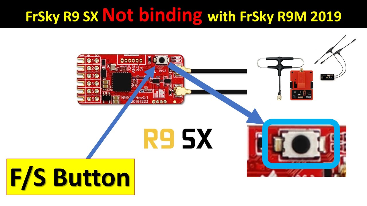

I was not able to bind them, however I could register Module successfully, but when I click on Receiver1 Bind, then it shows message “Waiting for RX…”, and this messages goes forever, I tried powering off and on Receiver, powering on receiver with bind button pressed, nothing helped me.
Then I have flashed both Transmitter and Receiver with the latest firmware, after flashing I could bind receiver, but It never connected, when I selected the Receiver option after binding it went forever waiting.
I am very pleased and happy to share solution I found for FrSky R9 SX being not binding with FrSky R9M 2019.
