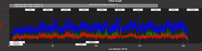

Hi, I just bought a pixhack and installed in on a F550 frame. I mounted it on the frame with four pads of kyosho zeal, expecting that the internal vibration dampener of the pixhack + the zeal would give me a perfect vibration-less drone.
When looking at the log file, I see quite some vibration though:
Is this normal for the pixhack? The complete logfile is here

To start its probably worth mentioning that since arducopter 3.3 (arduplane 3.4) a new scale for vibration measurement was introduced. So before acceptable x/y vibrations where ± 3 and -5 to +15 for z axis. Now anything less than 30 should be fine. I see that in general your z axis is over 30, but the X and Y are fairly acceptable. TO be honest the Z axis is the hardest axis to minimised the vibrations, even things like vibration dampers, or foam dont do much for the Z axis, so the main way to minimise that is to ensure your motors and propellers are properly balanced. What motors and props are you using?
Have you tried to fly your F550 yet? A couple months back I had some problems with my Z axis vibrations (due to very out of balance props) and the main affect was that it has very poor altitude hold ability, but I cant recall what my VibeZ readings where. But in your graph the average is 21, with an occasional max of 45 which should not cause much issues as its within the recommendations.
Hi Alex, thanks for your fast response, I use the DJI E305 motor\etc combo with the standard dji props.
I’ll check the balance of the motors and props to see how they are.
I also have issues with alt hold, the drone will sometimes go up and down about 50cm-1meter suddenly, seemingly without any reason. I’m using an SF11 rangefinder and I’m looking for a perfect steady alt hold, but no luck yet.
DJI gear is usually quite good but hopefully that’s the cause of the problems, but the z axis vibrations are likely the cause of the poor alt hold you are experiencing. Let me know how you get on :slight_smile:
