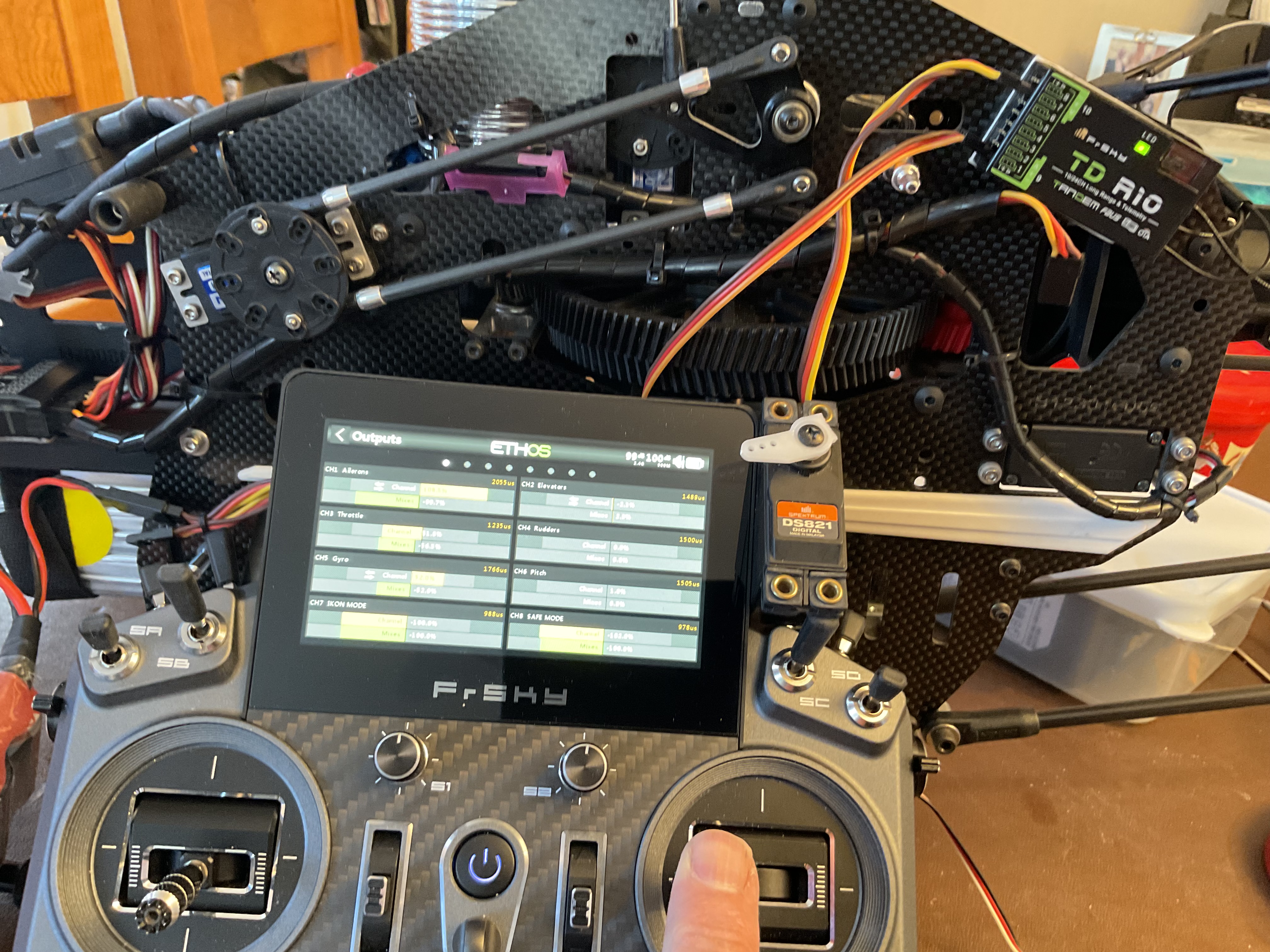

Aileron/FBus should work off Pin no 1. I was using FBus on a MSH Brain 2, but it would not work off Pin 1. Firmware was updated prior to this. I tried updating firmware and resetting the rx a number of times.Eventually I tried a servo in Pin 1. There was no output for aileron. All other pins worked ok. I re-mapped pin 1 to channel 24 and set aileron on pin 10 and the servo worked. I set FBus on pin 9. This allowed my MSH Brain 2 to work. Pin 1 is not working. TX is a Frsky X20 Pro.
Firmware updated and rx reset and registered a number of times. Remapping pins got it working but not pin 1. Pics attached of ail stick input. Servo remains in neutral with full stick. Elevator pic in neutral works with full stick.

1. Please ask the user to input a video and send it to us for review
2. Is the user’s steering gear directly plugged into the receiver? Or is it a gyroscope?
What is set for pin 1 in receiver Settings? (take pictures)
And the mixing interface to see how to set up? (take pictures)

Hi David, this all seems pointless. Putting it simply pin 1 is not working. It would not send out an fbus signal when I tried that and would not work when set as aileron on a bare setup. I remapped aileron to another pin and the receiver is fitted and working in a helicopter. The number of channels I need is ok. I have lost an output channel which is not the end of the world. I have been trying to move my models over to FrSky. Having over 30 it will take a while, although I have bought a few receivers and another transmitter from you so will get there. I have been flying models for 43 years lol. Just leave it. Iain
