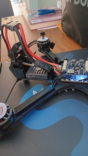

Fc build did not include CRSF protocol! so required immediate re-flashing to setup a receiver!
O4 unit activated and updated ok but upon powering by Vbat the unit is non operational, totally dead.
Fc reflashed with correct build.
              Hi Lootshoot,
Thanks for reaching out to us via DroneTrest and for providing your order details (Order Number: 736475, Manta5 Se O4 Lite Axm504lpnpgps).
I’m sorry to hear about the issues you’ve run into, firstly with the FC build not having CRSF enabled out of the box, and now with the O4 unit being non-operational after it had initially activated and updated. That’s definitely frustrating, and we want to help get this looked into.
Regarding the O4 unit, since it seems to have failed after being powered by Vbat (and potentially after your receiver installation), the next step involves us liaising with the manufacturer, AxisFlying, for a warranty assessment.
To help them process this and to rule out any potential installation-related causes, AxisFlying will require clear photographs of how your receiver has been soldered to the flight controller. Manufacturers often need this to understand the full context of an issue like this.
Could you please provide us with a few clear, well-lit photos focusing on your soldering work where the receiver is connected? The clearer these images are, the better it will help AxisFlying with their evaluation.
Once we have these photos, we can pass all the information on to AxisFlying on your behalf and see what the next steps are.
