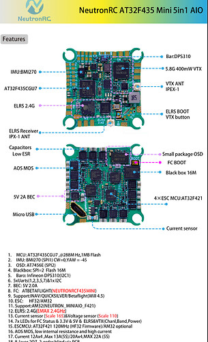

The problem seems to be with the onboard VTX. There appears to be a mismatch or interference with the video signal across channels — both in Betaflight and iNav. Initially, I thought it might be a configuration issue with iNav and the IRC Tramp protocol, but after further troubleshooting (including testing under Betaflight), I’m still seeing irregular frequency behavior. The goggles aren’t able to consistently pick up the video feed, and the available channels seem offset or misaligned.

As another potential option, since the flight controller and ELRS receiver part of your board is likely still working perfectly, you could just disable the faulty onboard VTX in Betaflight and wire in a tiny, separate VTX (like a PandaRC Nano or similar). It would involve a little extra soldering to the board’s power and video pads, but it could be a cheaper fix if you’re comfortable with the idea.

As for the other option you mentioned — disabling the onboard VTX and wiring in a separate one — I may still try that route, but part of the trouble I’ve run into with this specific AIO is that the pads which control VTX power are linked to the onboard ELRS as well. So disabling the VTX ends up disabling the receiver too, which kind of defeats the point. It feels a bit wasteful needing two extra modules just to replace one half-functional component.
