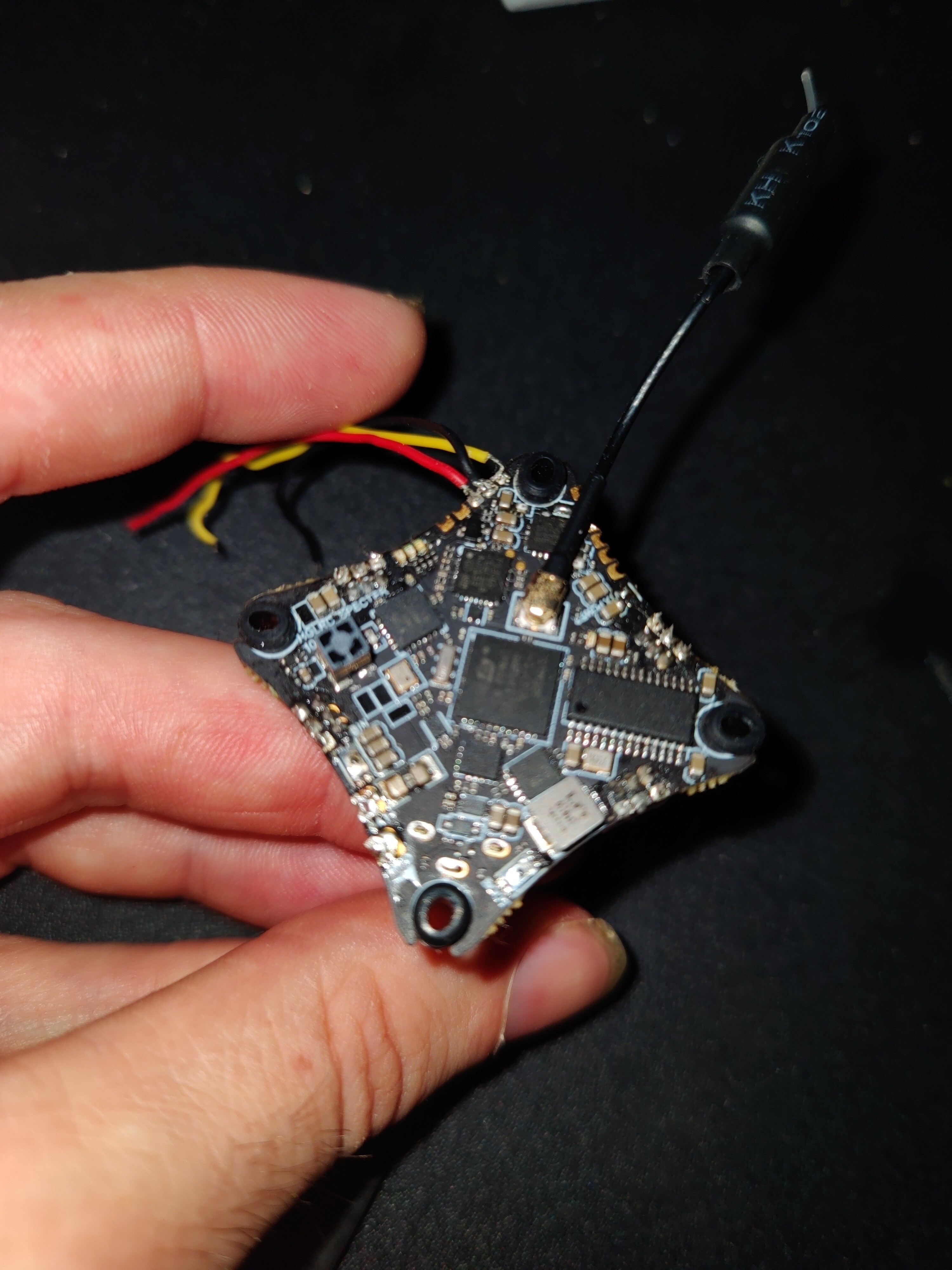

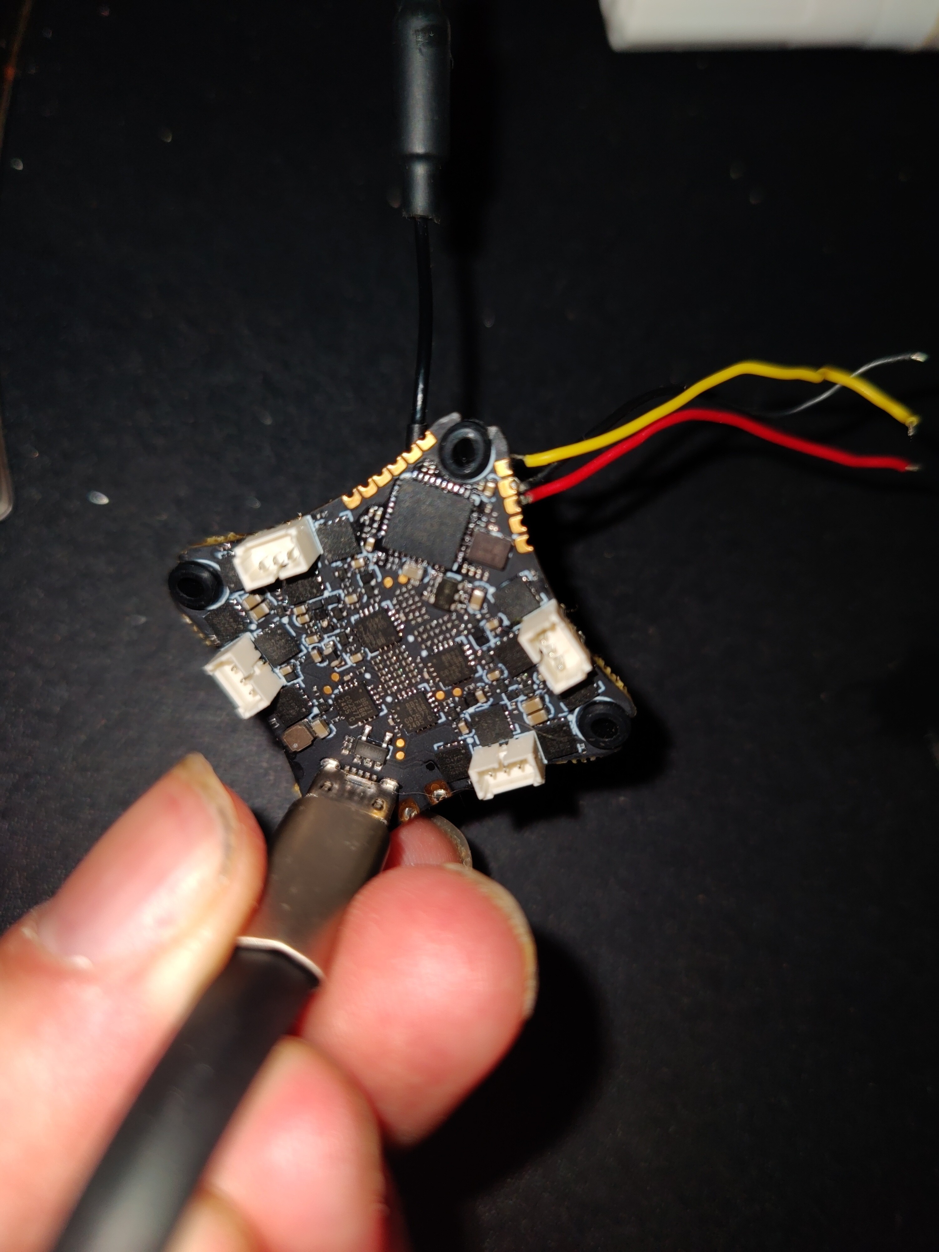

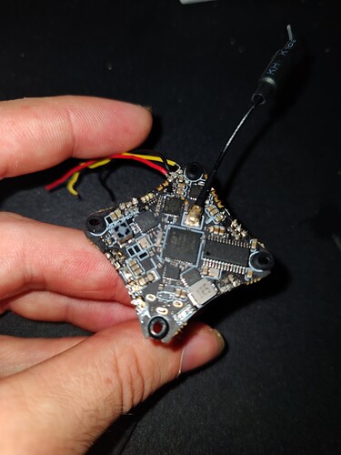

Board does not come on when i plug a battery in or when I connect the board to a pc after i have soldered everything as it should be
Checked all my soldering to make sure of no shorts and tried differnt cables to connect to pc and tried different batteries but still getting no power

Can you please send me some clear photos of the top and bottom side of the board and I will ask HGLRC to take a look for us.

Desoldering the AIO makes it really tricky to try and trouble shoot the issue now, but the board does seem to have possible soldering related damage. I have sent your images on to HGLRC and have asked their engineers to take a look for us.

I can confirm the board still does not power on after everything has been desoldered
Please see images below
Hi Adam good day,
We had some feedback from HGLRC regarding your AIO, they stated poor soldering as the probably cause to the issues you are experiencing with the board. Some good news however, after a number of emails back and forth with them, and a call for leniency, they have agreed to replace the unit for you.
