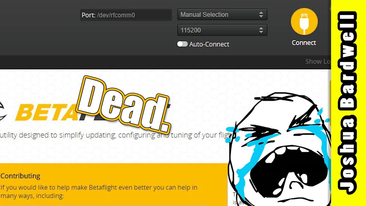

I think if you watch this Video i dont need to explain why your Betaflight didnt work ![]()

Wow I completely missed that part of Betaflight being moved off Chrome apps. I will try the new URL but that still doesn’t account for why my computers won’t recognize the quad as a USB device when I plug it in. Without that piece I still can’t get it to talk to Betaflight correct?
