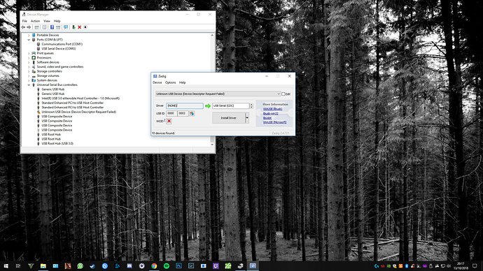

i am connecting by usb, both lights are on the fc - bluer and blinking red but im just getting a usb error in device manager
fyi battery also works

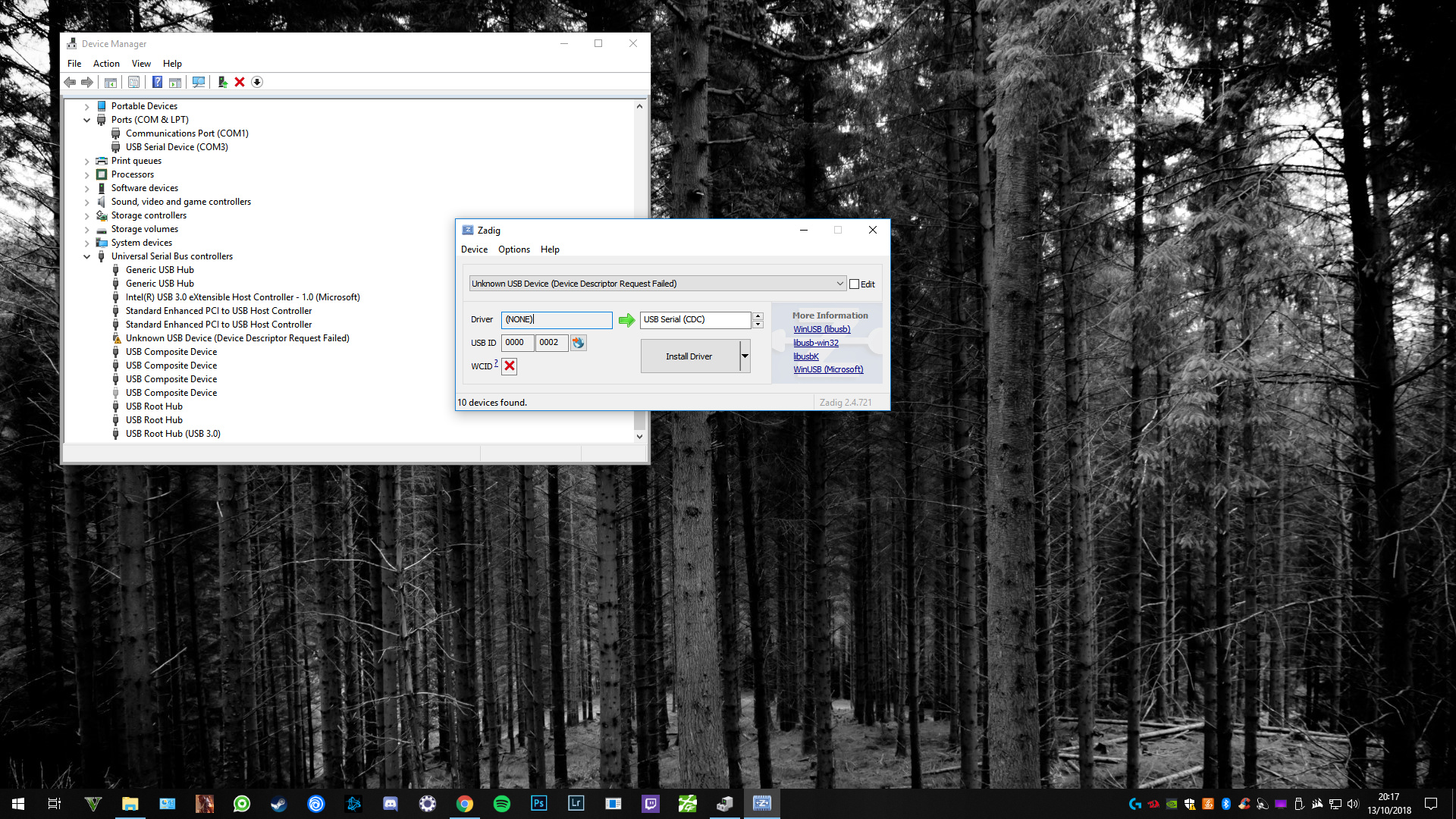

this is what im seeing in zadig btw. also notice in device manager its got the yellow ! on what should be the VCP
