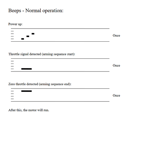

If I have understood correctly you asre not getting the second tone? Check this out. It is confirming the esc and fc are connected but its not detecting zero throttle to complete the arming sequence.
