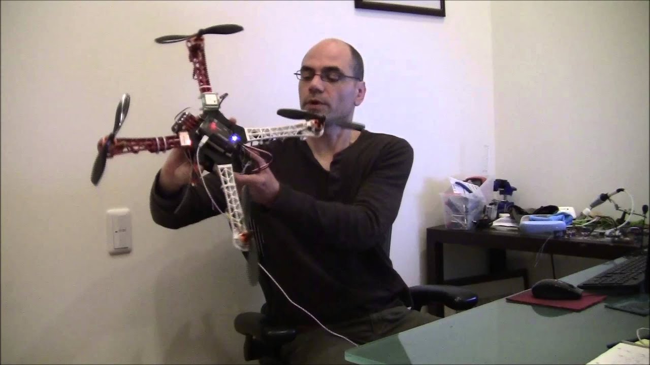

- Make sure you have calibrated your compass properly, you can find out some more information on how to calibrate your compass here

Simply enter a - sign in front of the number. But its better to do the calibration by rotating the quad as shown in the video

Are you not doing the automatic compass calibration?
