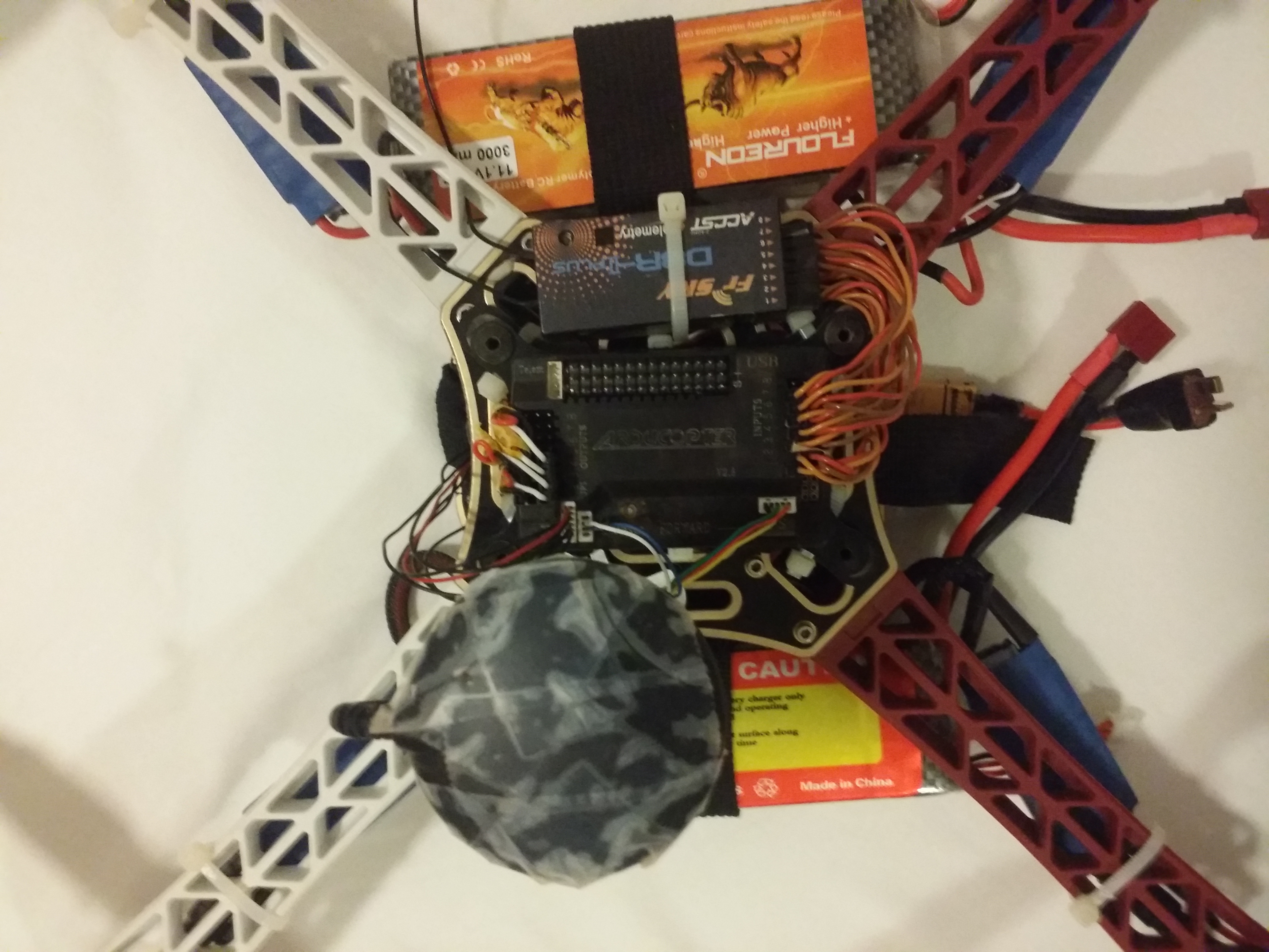

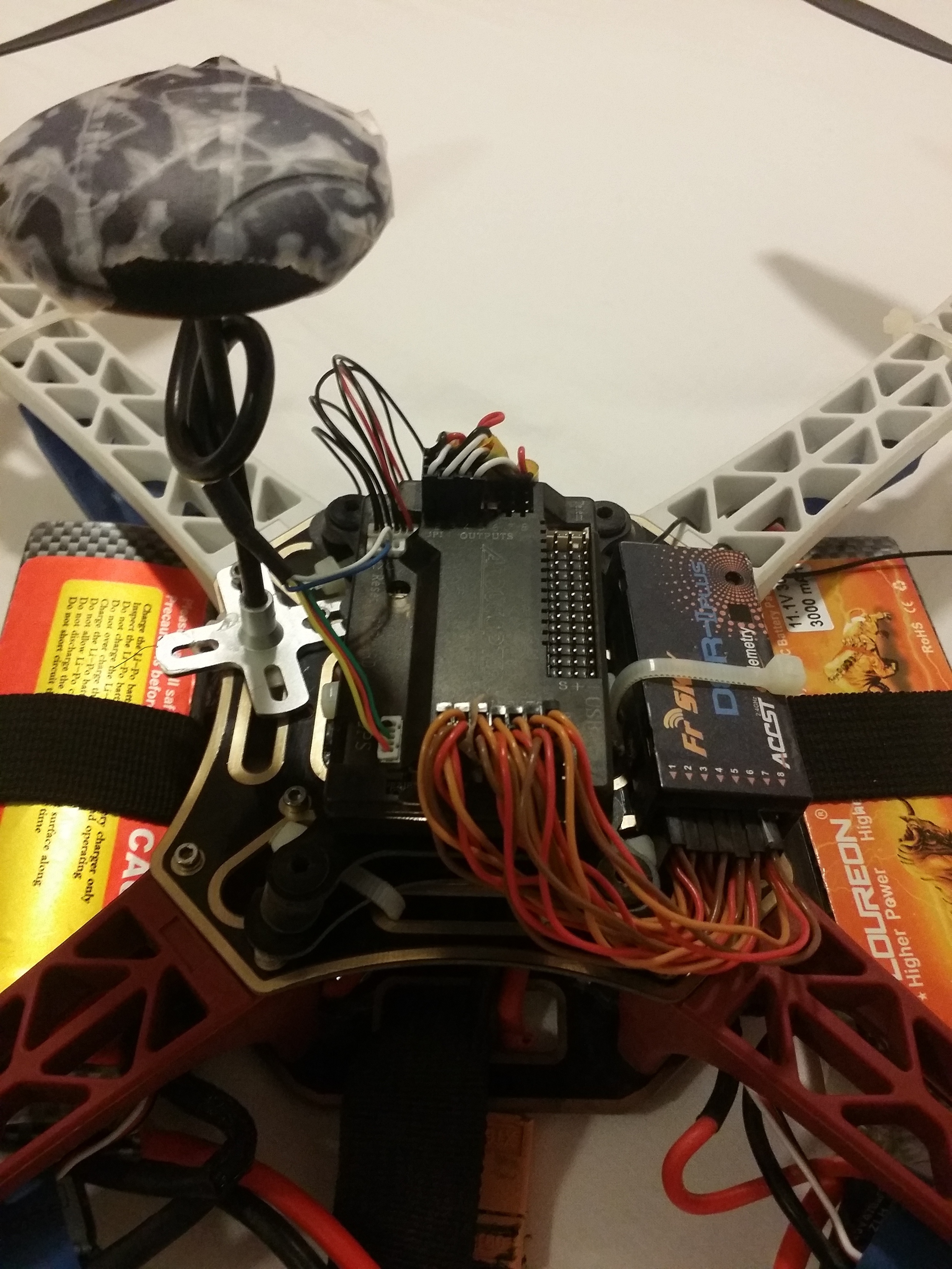

It could be a problem with your compass interference. Have you performed a compass calibration? And can you send a photo of how you have mounted and connected your GPS module?
Lastly would it be possible to send a log file for one of your flights and I can have a look to see if something else is wrong.
From the photos it does seem like everything is mounted ok, the GPS/Compass are on a mast away from interference. The APM is mounted onto a anti vibration plate. My only other suggestion would be to double check your compass calibration, and other settings again. It might be worth loading the firmware onto the APM again and starting from the beginning.
