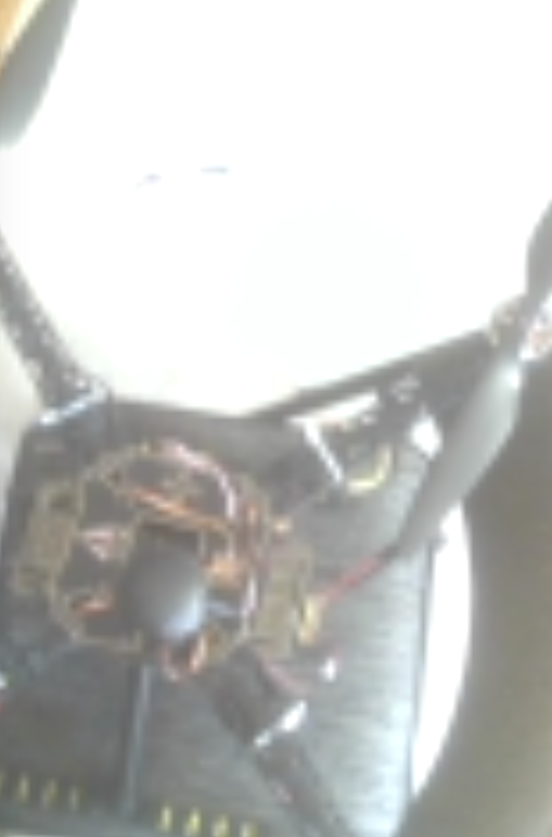

which says that you can and should use it on 3s with this motor. I will try to send a video of it flying when I can. I am using velcro to attach the APM to the quad, does that eliminate enough vibrations or should I get a real anti-vibration mount for the APM? I’ll try redoing the compass calibration and compass motor calibration. The compass is on the center-right of the quadcopter. Here’s a (bad quality from my webcam) picture:

If your APM is mounted just with Velcro that could actually cause more vibrations if it’s not totally secure and the board itself can move slightly independent on the frame. Check this post for some more info on vibration damping
